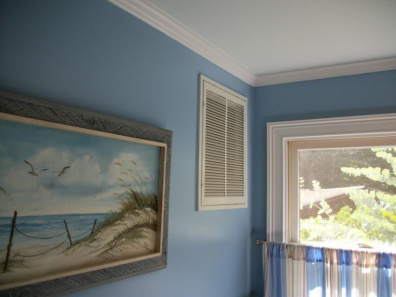

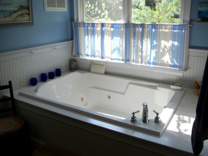

Inspected 36 year old trailer modified/updated interior with additions added on. Tax records indicated single dwelling. One addition approximately 8 years old had cold air return in bathroom wall. Need suggestions on comments on return being in bathroom. Any help with wording would be appreciated.

Please be advised that the return air location at ****** bath may intermittently affect the aroma of the air quality at other locations within this structure. My advice is to consult with your qualified HVAC specialist about relocating this return grill outside of the bathroom and sealing the original grill location.
There were 2 units. The one in question served the new addition of the master bedroom and bathroom. The thermostat was located in the master bedroom. The air handler was located on the other side of the wall in a closet and there was only one return.
Write up what you see, inform them of possible consequences and recommend a heating company.
Return air is improperly installed in bathroom. This can result in premature rusting (high humidity and hair spray are two examples) in furnace and likely reduce the performance of the air conditioner due to the presents of high moisture - especially when taking a shower. Recommend having a heating company make corrections.
Nobody should install return air registers in bathrooms, kitchens or garages.

irc states in section m1602.2 prohibited sources for return air part 4 a closet,bathroom,toilet room kitchen,garage,mechanical room,furnace room or other dwelling

i am a licensed mechanical inspector for the state of michigan. when i find this situation on a home inspection i only state that it is not standard installation practice.i do not quote any code.when i am on a mechanical inspection i make the contractor change it.
