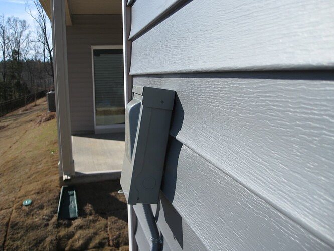

Compressor Disconnect box slope inward on a vinyl wall
Hello all, I just completed a new house. The compressor disconnect-box top has slope towards the wall (please see the photo). I think this is an issue, since water will be shed along the vinyl siding and protentional enters the penetration. Is this correct? Thanks a lot!
Not something i would write up. Looks fine.
It’s fine. Don’t forget the receptacle within 25’ of the compressor.
I like the way you are thinking…follow the water. Wall protrusions should be sealed. In this case, you cannot see it. The small surface area and slant are not a concern. And, you cannot report on what you cannot see. So personally I would not report on this.
Not a problem, this is the norm for installing disconnects, at least in SW Ohio. On the other hand I do call out meter sockets that aren’t properly installed and flashed.
typical new construction, nothing I would have reported on…
If I can see that there is an opening into the home not sealed, I usually put it in my report. I think if you look closely at the picture, you can see that opening. How much water will get in? Probably not much. But some, nonetheless.

It looks like the spacer tab on the back of the box. :slightly_smiling_face:
I typically don’t call it out on vinyl, because of the wrb, but I do call out the lack of sealant around the box on block wall construction.
