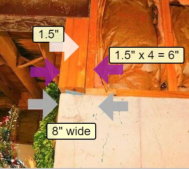

Concrete foundation crack
My question was there any additional reinforcing steel under the load bearing area. If not that corner could shear off. The rust stains at the bottom of that crack is a red flag to me.
1: Bearing is 1.5", even for the build up wood column - steel beam/girder column intersection if there is a tapered flag. I did not look closely.

4: As for the vertical crack. I would recommend, Monitor yearly due to the location.
The typical concrete compressive strength used in residential construction is 2,500 or 3,000 psi, although other strengths are available. I used 3,000 and higher.

How wide/thick is the poured concrete wall?
In my neck of the woods, 10" to 12", but the standard is as you know, 8’ inches as a ‘minimum’ for 6’ foot foundation walls - 10" inches thick on walls taller than 8’ feet.
If/when all things are equal, 1.5: bearing is required.
I uploaded a dimensional illustration to illustrate component dimensions in question.
Illustration
Looks like a foundation corner pop with a point load bearing on it. In addition, the 3 member 2x6 bearing column is lacking a solid bottom sill plate/block. Water is penetrating the crack. I would refer to structural engineer and foundation repair contractor.
It’s there Russel, but only 2 members are really bearing on it. That first one doesn’t amount to much. I bet that crack is also in the inside corner on the outside.
Yes, I see that the block is there. Had to use the magnifier to see it. Thanks.

Report it … Refer to a foundation contractor for evaluation and repair if needed.

It looks like point loading to me. The scenario I envision is the (blue arrow) 2x was placed then beam was set. The (red arrows) other 2x were placed later. It is fuzzy when I blow it up, but they look shorter. And depending on how the foundation wall is reinforced, would determine if it is a big deal or not.
Recommend having the crack monitored and evaluated by a structural engineer.
