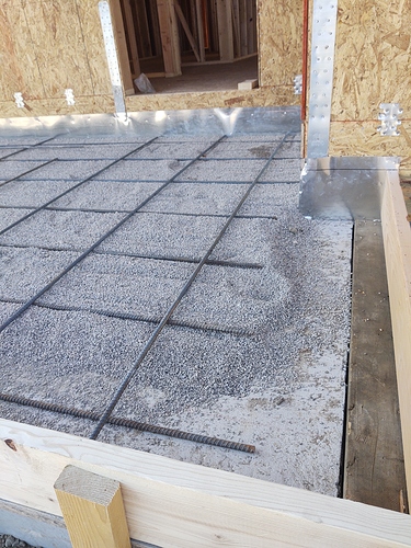

I will indeed :blush:. Only had commercial jobs today so will go cruise some new subdivisions that I pass on the way home and see what I can come up with.
Okay, well these aren’t EXACTLY what I was referring too but it is pretty close.

Full depth of basement porch area to be used as a safe room. Inner wall had a door blocked out in the forms.
Different houses but identical foundation set ups.
Hope this helps
Here you go Scott :slightly_smiling_face:
Thank you for going out of your way and taking the pics :+1: :smiley:
