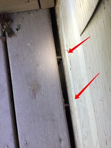

The ledger bolts were thru bolts, threads/nuts exposed on the exterior. Which tells me this was attached to a rim band as you stated. I was able to see the floor structure in the mechanical closet…they were engineered i-joists which makes it even more interesting. Then for some additional fun, they notched the ledger board real good.

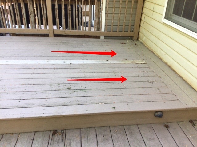

This one was barely attached to the house. The ledger was set below the band point and barely hanging on. Staircase was racked and had settled to the right. Damaged railings, etc. This is a total replacement. Recommending anything less is irresponsible.
This one was literally detaching from the house during the inspection. It had dropped hard on the left side and the lag bolts were literally pulling out of the wall right in front of me.
Significant repairs or total replacement.

This was from yesterday… joists were cantilevered, and extended, but the deck band joist was only nailed to the posts, and wood was rotted and splitting, and steps/ landing were racked, as well as splitting.
I wrote hard on this one. That band joist is supporting half the deck.
