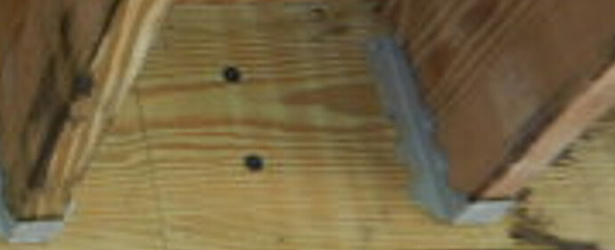

Deck attached to cantilevered floor
I’m sure glad I’ve getting some good interaction from everyone in the inspection business. This will go down in my report as a defect that needs to be repaired ASAP, this is a SAFETY issue regardless if its code or not (but we all know it is). The buyers have been made aware of the repairs that need to be made.

That deck needs to be repaired in a manner that provides a freestanding structure independent of the ledger attachment. Essentially a second post and beam support must be added close to the home. You cannot attach to a cantilever and you have no idea when that may fail. Could be tomorrow if you put enough load on it. As inspectors we can rarely see the true condition of the sheathing and framing behind the ledger attachment, so why risk the potential liability? No ledger flashing increases the risk significantly as water can follow the fasteners into the framing.

I would agree with Brian that the deck is newer than 1998. The ledger is attached with ledger lock screws and not lag bolts, so that’s a clear clue that it is not as old. Not enough of them installed either. They are compliant when installed properly. They were specifically designed to replace older hardware options.
The freestanding repair should be a common call out in your reports. It’s a relatively easy fix. Adding a second post and beam structure will cost about $3,500 depending on where you live. It’s not a deal killer and should be a regular thing that your realtors should get used to seeing.
Calling for further evaluation is weak and unnecessary. It’s wrong. Just fix it.
I’m not sure how you can make the determination those are ledgerloks from the provided pictures.
Size, color, and contractor experience my friend.
Ledger attachment is largely irrelevant once it is freestanding. So who cares about the fasteners? If you fix this correctly, the fasteners are irrelevant because the new beam holds the weight.
Two proper beams = no chance of failure = no liability.

It doesn’t matter Marcel. (But they are ledger lock screws) The whole point of the DCA6 and the 2015/2018 code changes for decks is to make them freestanding to avoid ledger detachment failure issues. This is a very simple common sense thing that can easily be addressed by adding a second beam. Arguing about fasteners is pointless because a deck really shouldn’t be attached by the ledger anymore, so the fasteners are irrelevant. Too many have failed and caused serious injuries and death as a result of the old single beam and ledger attachment. Home inspectors should start taking this seriously and reporting with language that emphasizes this issue. We have a duty to report the potential concerns and the severity of the defect. I’ve had two decks in the last two weeks which were imminent life safety hazards as a result of this exact issue. There are tons more out there all over the country. If you’re not telling your buyers to make these decks freestanding and in some cases, replace the entire deck, then you are opening yourselves up to all kinds of liability.

Ledger was being supported by a cantilevered structure, was not properly attached to the structure and lacked flashing.
I agree with Ryan that adding another beam and post system would fix the problem, and I verbally recommend this to my clients all the time.
Write it up for all houses, especially for older houses that were not engineered to have decks installed. A deck can be supported by a cantilever if it is 6 foot or less in length, in most cases. Again always ask for approved permits for all decks as they fall off houses quite often, especially when people take pictures at party time. An additional support girder will need to be installed unless of course the deck has an approved permit as the town engineer will have seen the exposed framing that may extend into the house as required.
