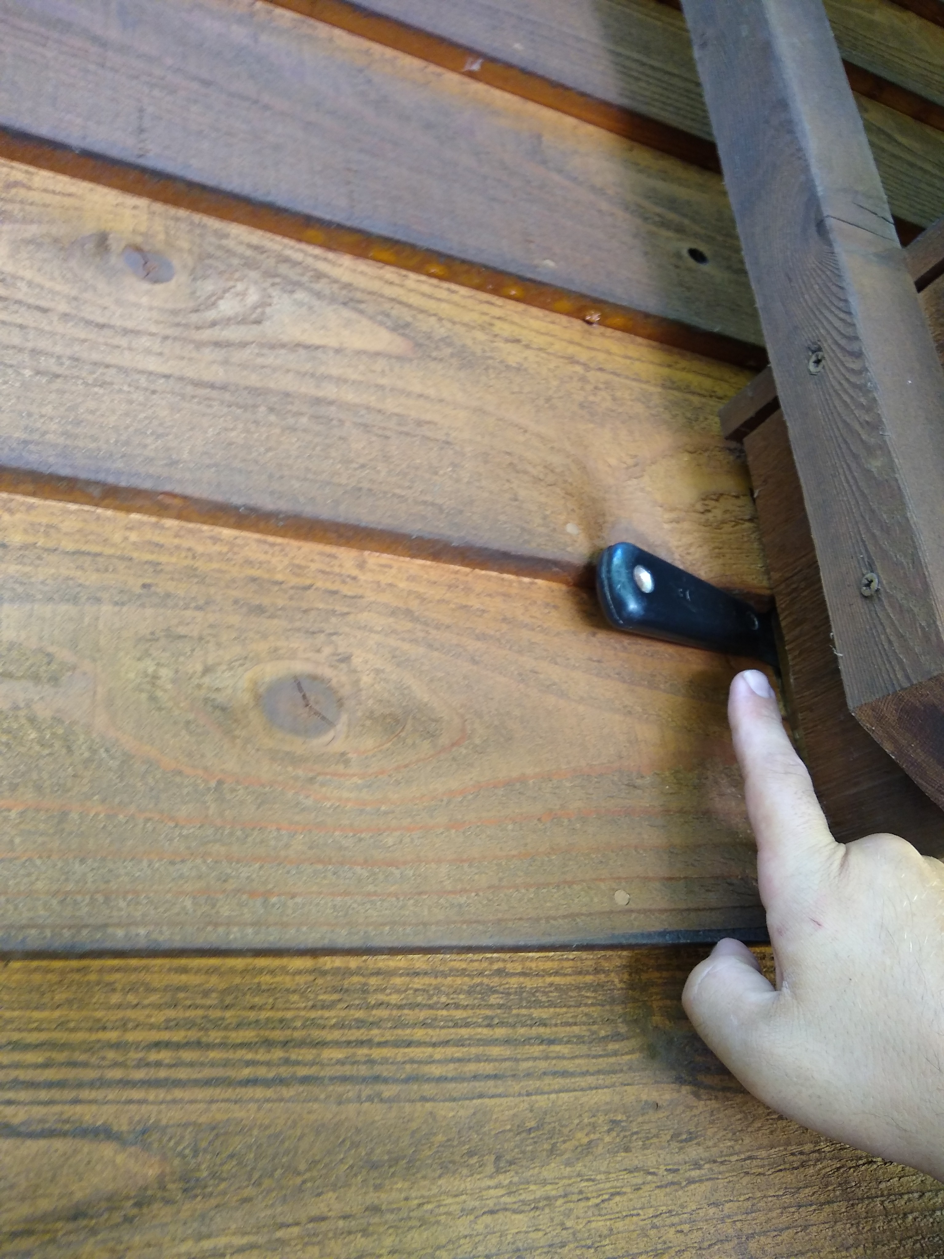

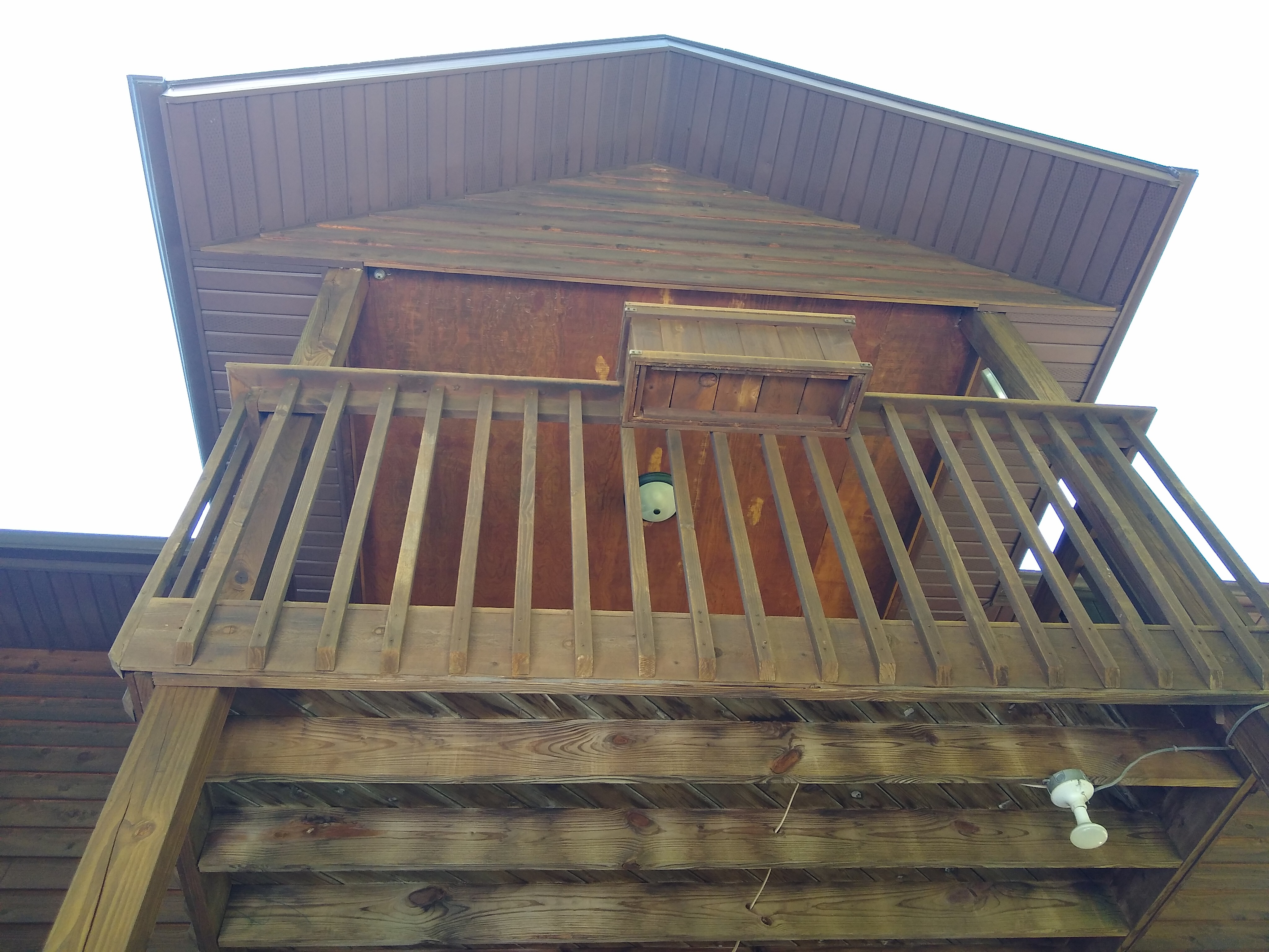

This balcony is attached by ledger. Originally I thought it was cantilevered, but then I was able to see that it’s not. I used a putty knife to show that. The ledger is nailed on and appears to be pulling a little. There’s no flashing which I’m not concerned about because there’s a roof over it. My question is shouldn’t the deck joists be perpendicular to the house and attached to the ledger board?

So, what actually supports the floor joists? How is the rim boards (supporting the floor joists) attached to the ledger? There is a very peculiar load distribution across the floor joists which do not seem properly supported. In a conventional build the ledger attaches to the home with multiple fasteners, the other end of the floor joists are supported by a beam and posts. None of that happens here. You need a structural engineer.
Deck lacked proper fasteners of the ledger board to the house. Joists lacked hangers. And yes…awesome question about the direction of the joists… totally seems they should be run perpendicular to the house/ledger. Also, for the height, there should be some additional bracing/diagonal bracing. I don’t remember if the online class discussed the direction of the joists? Might consult with a structural engineer and/or contractor for more insight on the joist direction. Please let me know…I’ll ask around too.
Well, looks like it also lacking proper fasteners at the posts, missing joist hangers, single headers. I’m pretty sure it is also missing proper connectors at top rail (to post).
Its just missing a lot of hardware and it’s too high up to let it go.

Lol yes I realize rain doesn’t come straight down. I still noted in report there wasn’t any ledger flashing, and I also noted there was no damage found. It is well covered by the roof structure. From what I could see, the only thing securing the parallel floor joists to the house was the 2 perpendicular joists on the ends attached to the ledger. Of course, you can say that the floor planking is adding some connection, but that’s certainly limited. And not what they’re designed for. I also noted the fastener only beam connection to the posts and that the posts are a shared load with the roof and and deck. I called for structural evaluation.

The deck is not attached to the home by a ledger. The joists run parallel to the home between two doublers. The doubler attachment to the home structure would be your main concern. I see no problem at all here.

“Between two doublers”? What’s a doubler? I’m guessing you mean double joists? They aren’t doubled up. That’s 3/4" cedar cladding nailed to the outer joists.
Yeap, it’s held in place by the rim joists, insane! Kenton must have missed the pic with the drywall knife. Even if they were double and properly attached to the house, I’d still call it out as they would carry the load of the entire deck. When a ledger is used the load is spread across all joists. In this case the load is carried by 2 single 2x rim joists.
That deck is a BIG PROBLEM and a POTENTIAL KILLER.
Refer it out to a Qualified Deck Specialist, Qualified Contractor or a Structural Engineer or look for a lawsuit waiting to happen!

Typically, joists would be oriented perpendicular to the home exterior wall and would be connected to a doubled rim joist at their other end. In this case, the joists are oriented parallel to the exterior wall and are fastened to single joists along either side. I would call single joists out as inadequate and recommend a Structural Engineer evaluation. The bearing joist connection to the home structure is also a concern since you can’t see it and the framing is structurally suspect anyway.
My narrative would be something like “Deck framing was non-typical and appeared to be structurally inadequate. The Inspector recommends evaluation by a structural engineer to ensure that safe conditions exist”.
