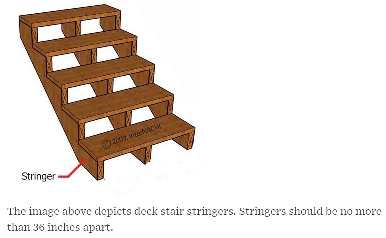

Noted two different references on InterNACHI?
Course shows below: The image above depicts deck stair stringers. Stringers should be no more than 16 inches apart for wood decking and 12 inches for composite.
But Library shows: The image above depicts deck stair stringers. Stringers should be no more than 36 inches apart.

Seems like these stringer spacing rules should also apply to any open riser stairway (ie basment stairs with no risers) too? Not sure why they would say 36", then additional requirements for wood and composite? Are they tring to say metal is ok at 36"?

Probably a mistake…
Thinking a typo on the 36" spacing.
So most likly stringers should be no more than 16 inches apart for wood decking and 12 inches for composite, but should this rule also be applied even to any open riser stairway? Example - 36" wide wood basement set stairs with open risers, should it also have additional stringers, or is this just a concern cause of exterior conditions?
I’m assuming, a deck stairway with risers, does not require the extra stringers because of the riser support?

The stringer spacing depends on thickness and the material of the treads. Did you look it up in the DCA6?

Jim; 2 inch nominal lumber treads (2 x 6, etc) can span 24 inch. Bull nose 5/4 treads can span 16 inches. Same for composite material, 16 inch. That dictates your stringer spacing.

But does this only apply to exterior stairs or just open riser type stairs, because I see many 30"+ wide basement (interior) stairways with risers that only have 2 stringers and never thought twice, they are strong?
Take the risers out and it’s another story…

I don’t know that answer about the riser/tread question without looking it up in IRC code. However, when the riser and tread are connected together in a secure manner as illustrated in your picture, you obviously have much greater load capacity. Nothing wrong with that tread and stringer design in my opinion. Good thing to look up in the code book if so inclined. When dealing with old construction, one method I use is to walk up/down the stairs, do the “jump test” - does it pass?
Lots of old homes, especially cellar stairs, were built with 2 x treads, no risers, and two stringers built with 2 x 10’s. I’ll call that out with the caveat that building practices have changed since the time the stairs were built. Issues: safety for the buyer, liability and credability for me if I don’t mention it. It’s your call and opinion on how you address old construction practices.

According to TREX (the leading brand of composite decking) the stringer spacing should not exceed 9" for their “enhance” line or 12" for their premium “transcend” and “Select” lines.
I’m 150 lbs and I have found decks with composite stairs on 16" OC spacing to be too flexible and I call them out (with reference to manufacturer instructions below)

Thanks all, great info. That TREX design should last forever…
