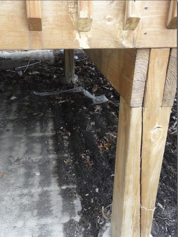

Any concerns with this installation.
Not unless I am missing something.

I knew it looked right just dont usually see the beam cut that way around here, and I misplaced my diagrams.
Thanks.
Should be using a bracket rather than a splice cut cut.
Looks good…

I misspoke thinking of the porch requirements as illustrated below…
Does everyone see the difference and why there is one?

Bob, for anti-rotational purposes, this is a better connection for that size lumber on post to beam connection. :slight_smile:

Yep,plus when you splice a support post with another level(above it) you just cut that support strength in half with the splice.
That is the reason for the bracket requirement on porches.
Splicing posts to themselves is allowed with 5 thru bolts however.

Now tell me what caused this?

To much of a overcut or does the splice weaken the grain?
Check cracking enhanced by the notching and what is holding up the center 2x of that beam.?
Post to beam connecter bracket should have been used for that. :slight_smile:
Check cracking enhanced by the notching:):):slight_smile:
That is not use of carpentry skills.

Robert how long can those support joists be with only one row of post supports?
