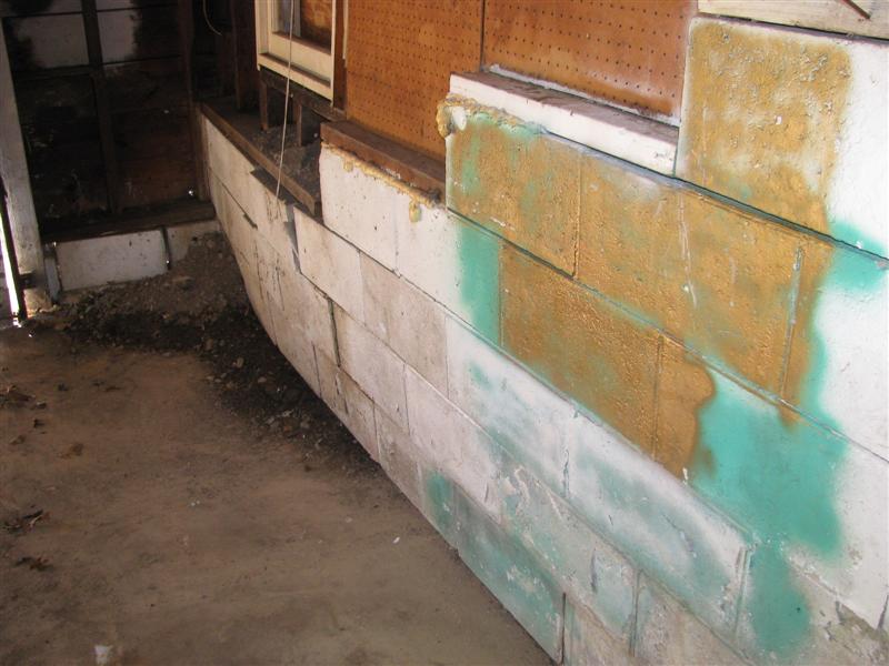

This garage was partially built into a hillside with trees growing against the footings. One side wall and the entire rear wall are seriously structurally compromised. Walls are leaning inward from the top by as much as 4", in addition to bulging, displacement and joint cracking. House was constructed late 1950’s, garage appears to be about the same vintage.

The photos were posted because I thought members would have an interest in viewing the images. I guess the only question is how close is this garage to collapse?
No one can predict how much time these walls have before they suddenly collapse, but I would simply recommend that this entire structure be evaluated by a structural engineer.

Seriously, you could simply call for a repair or demolition in this case, couldn’t you? No expert is going to call this acceptable, so an evaluation is just a waste of $$, IMO.

Repair of this structure would be very difficult and more expensive than demolition and re-construction, all of which was discussed with my client during the inspection. Yes, in many ways a structural evaluation would be a waste of money, but I am not comfortable recommending demolition in the report. Other comments regarding the obvious instability of the building were specifically written in the report. This is a forclosure sale and there were many other issues with the home.
