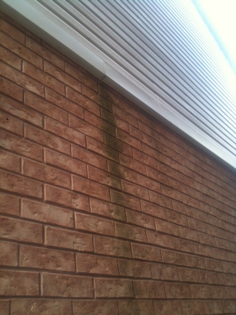

It seems like rain is being caught in the bottom flashing of this siding and then running out the seam. Is there something wrong with the flashing detail?

The starter script for the vinyl siding acts like a gutter.
What you’re looking at is a joint for this “gutter system”.

The pic needs to be rotated 90 degrees clockwise i.e. the brick is on the first floor with vinyl on the second floor.

My question is…is there a better way this bottom flashing could have been done?
The answer to your question is “yes”!
The reality is; this is how it’s done everywhere.
The other reality is that most moisture intrusion is associated with conditions such as this (particularly if inadequate flashing is not installed which cannot be assessed during a home inspection). Unfortunately home inspectors are not prepared to provide documentation of this particular circumstance.
Use of a starter strip instead of “J” channel alleviates this type of staining.

Staining is from a fastener. WHY?
Also expansion allowing the siding to heave.
It maybe to tight. You install siding lose. So each piece can expand and contract alone. Without appling load to any connecting length.

That element (ledge or shelf) is wrong. IMO
A 15% angle. The brick should be visible. Applied atop of the masonry.
If you are using wood or plastic for the shelf:
First a Z flashing, IE, ice shield before any metal or plastic… 2) shelf of ledge with a 15% angle towards the yard , 3) counter flashing/s 4) the starter strip, 5) A bead of caulk (silicon) on laping or protrusions.

A) If they used a proper fastener the staining will not appear.
B) If it was water/weather tight the fastener would not bleed.
The fastener is degrading.

Look at the photo. It’s where the trim overlaps. Water gets in the trim and comes out of the overlap. Why would you caulk the overlaps? The water can’t get out then.

Ether/or That should not be happening. As explained, I would prefer to see a ledge flashed properly then the siding applied.
You can not see the transition. Leaves to many variables that may allow weather or water migration.

My home done this way what I did was just drill a series of 3/8 holes every 8 inches so the water drained out everywhere and not in any one concentrated area.
The transition is quite simple when you think of it.
You separate both materials to allow expansion and contraction, like step flashing. So they can move independently.
The are 3 flashing steps and the materials are metal and rubberized membrane.
The later did not exist when I flashed the components.
- flashing under the brick in an 15% angled rowlock position.
- Flashing under the starter siding.
If you wish you can add membrane from the 4" up the sheathing and 2’ onto the brick. onto the brick

I guess if the builder had used a proper starter strip, this wouldn’t have happened.
