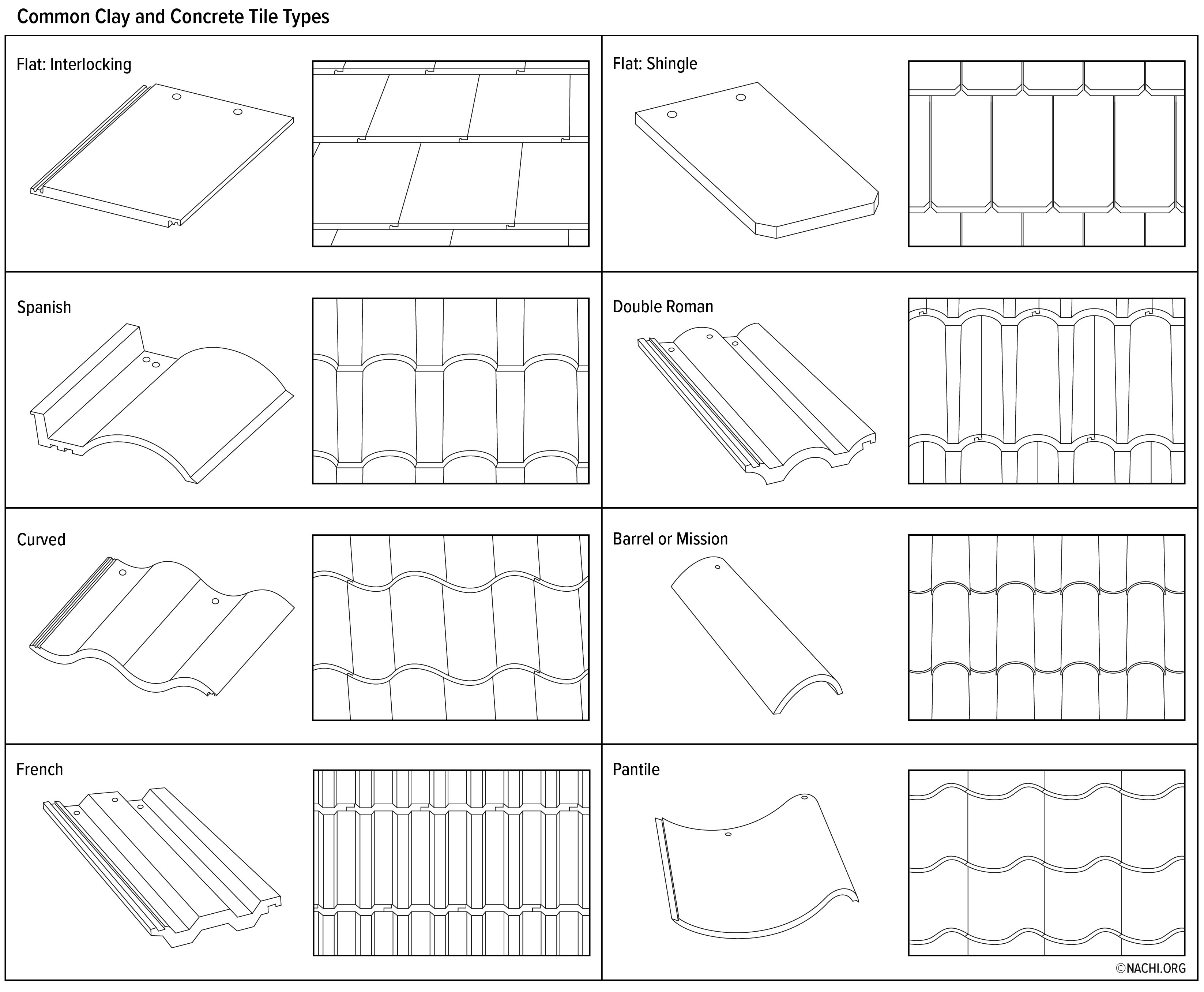

Draft image: Common Clay and Concrete Tile Types
I’ve attached a new draft image to preview, before finalizing. I’d like to hear any valuable feedback from the forum. Your experience helps to make these improvements to add to make quality images. Thank you!
Hi Zak, the tile in the figure labeled ‘barrel’ looks like a barrel hip/ridge cap.Barrel tile in this area generally have this type of configuration:

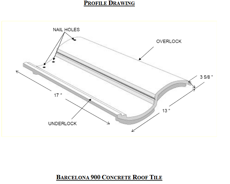

This is an Eagle Capistrano
Boral makes a similar profile, Barcelona:
Low Profile (flat), Medium Profile (M or Double Roll) and High Profile ( S or Barrel) are common terminology here.
