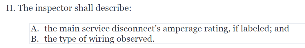

Client understands water and rust but takes issue with my labeling the service in each panel as 60 amp. A 60 amp breaker in the middle of the left row of breakers is labeled as “main”. Am i correct in labeling these 2 panels as having 60 amp service? The client may be making a case that these GE panels are labeled as rated for 100 amp and that they could be upgraded to 100 amp if the incoming service and main were upgraded to 100 amp.

The panel rating and the actual service may be two different things. The service and the disconnect rating may be two different things. Per the SOP we should do the following

A 60 amp breaker labeled Main is typically an indication of a split bus panel.
Good point. It could actually be a 100 amp or larger service with the 60 amp feeding the split section. If it is split bus you would then need to know the service entrance conductor size.
