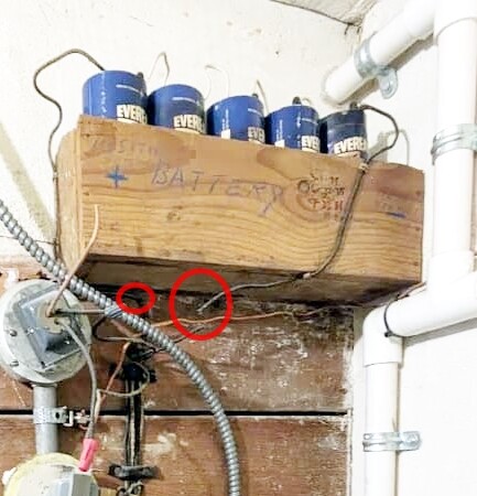

Any idea what these batteries might have been for?

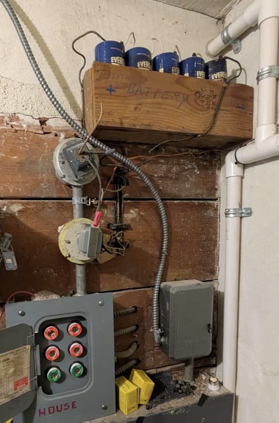

Was anything in that box under the batteries?
There are two transformers above the house fuse panel: the top one charges the batteries.
The metal bx cable runs a timer switch for common area lights.
The box just holds the batteries.
The neighboring building of similar era had the same batteries, just yellow.
Some kind of POTS phone connection or alarm power, maybe.
I count 10 x 1.5V Eveready batteries in series. 15V. Connected to step-down transformers.
Usual/normal/typical old doorbell voltage step-down transformer stepped down 120V AC household voltage to a low voltage of 8 to 16 volts AC.
No more ability to send current. Open Circuits.
Was Doorbell power, when needed, is my wag.

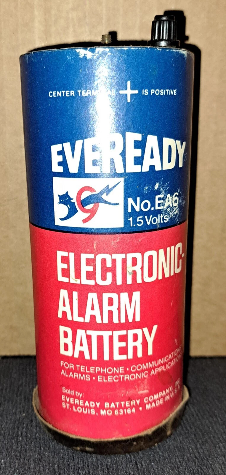

Applying an electrical current to an old time carbon / zinc battery is a worthless pursuit. It is not only ineffective (the chemical reaction is irreversible) it could possibly explode. In order to even begin answering the original question you’d have to know exactly what type of battery was being used.

This is for the doorbell back in the 50’s.

They used to be connected to a doorbell-like transformer: you noticed the cut wires.
So the house power would charge the batteries.

It is chemically impossible for those dry cell batteries to be recharged. Explode maybe but recharge no.

Personally I do not think the batteries were charged. When exhausted the batteries were discarded.
French Battery and Carbon Company to Ray-O-Vac in 1934.
June 15, 1993, the French Rayovac announced its "reusable alkaline battery system. alkaline manganese (RAM) system.

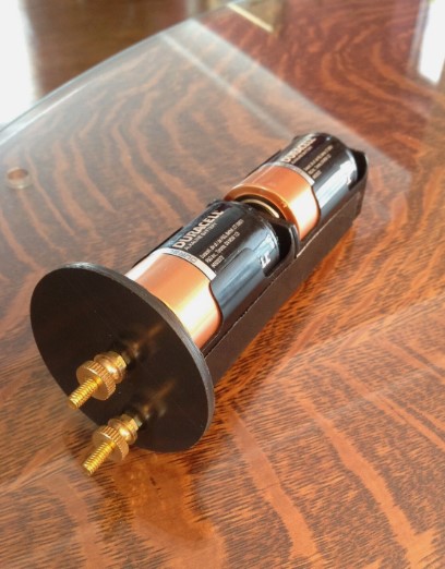

Refillable #6 Rayco Ray-O-Vac dry cell… Positive and negative brass poles with knurled thumb nuts like the original batteries are powered by two modern D-cell batteries that are completely refillable .
