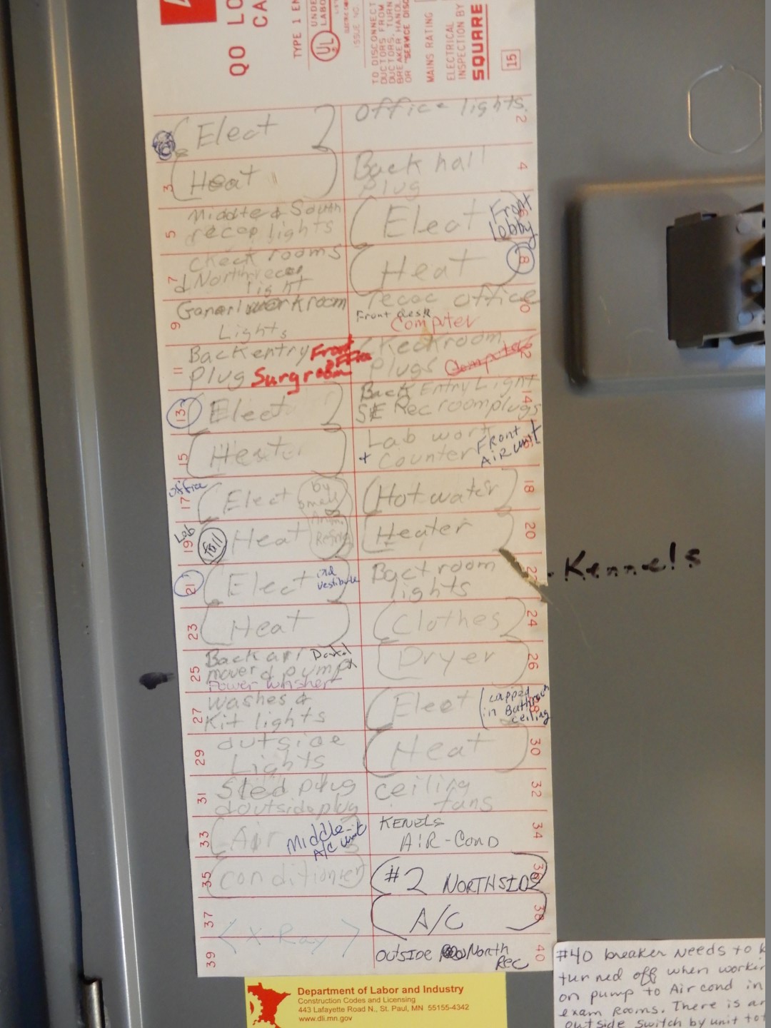

___________ are not necessarily considered electrical panel defects.

Inaccurately labeled breakers !
Correct answer. :+1:
Just say’in. I’ll call out inaccurately labeled breakers. Likely to say little about moderate rust.
If that is the correct answer that means that wire splices are defects?
Uh no? Wire splices is the correct answer. Splices are allowed in the panel. Breakers have to be accurately labeled per NEC.

Agree… and for anyone that want’s to argue… it is “assumed that the splices are made and protected properly”!
yes , definitely wire splices
My bad, I assumed that the splices were hot and not properly protected, which is why I went with inaccurately labeled breakers as the answer.
So really, there are two correct answers, if one assumes that the wires are hot and aren’t properly protected.
At least you admit it! :face_with_raised_eyebrow:
How do you know the label is wrong? Are you flipping breakers off one by one and checking if it turns off the correct thing on the label,?
“incomplete, illegible, confusing, cluttered…” :thinking:
