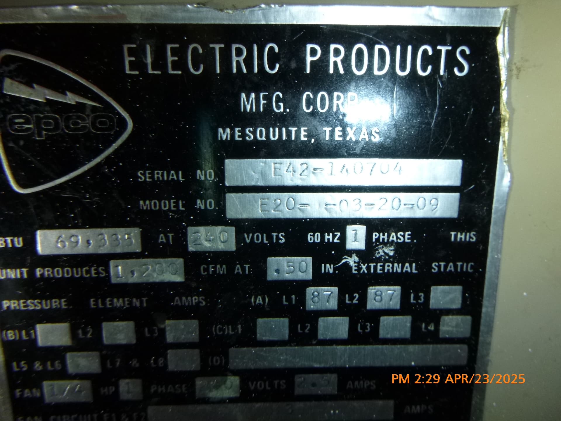

Now fast forward 12 years and I found my second EPCO unit. I still do not know when it was made. Likely to be 1974 (the age of the house).
Anyone got any pics of these elusive units?
How about a photo of the unit?
Here’s the data plate
