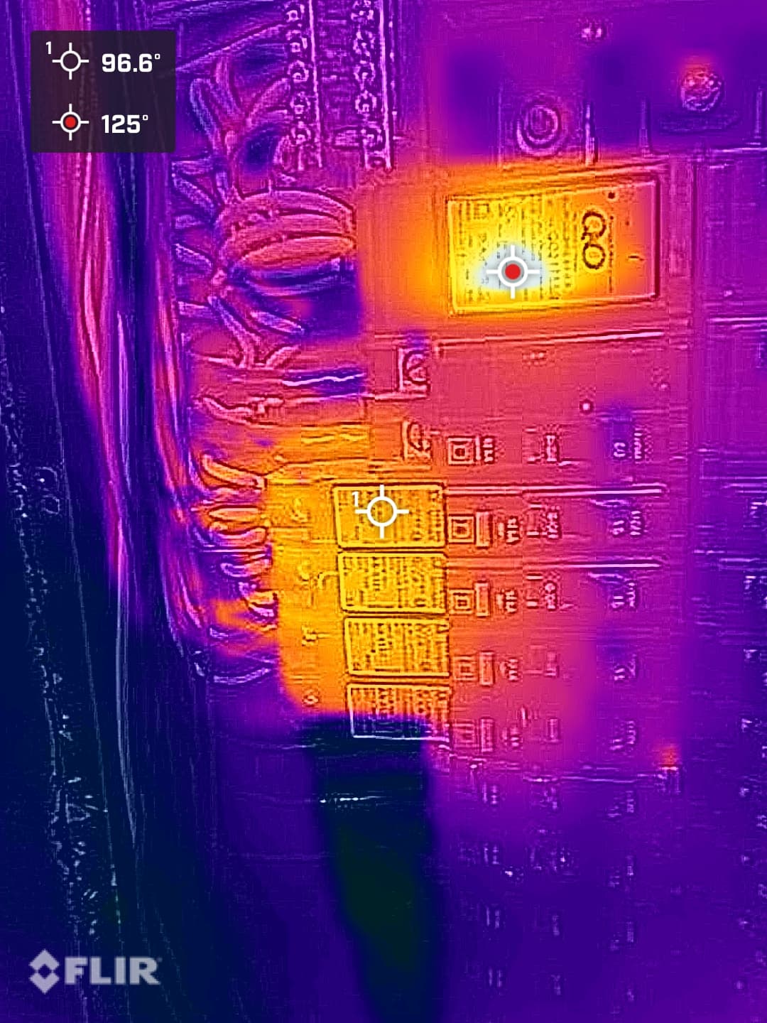

I am practicing electrical inspections and recently got an infrared camera “Flir One Edge Pro”. I noticed that this 30 amp surge protector was showing 120 degrees farenheit. The AFCIs were also emitting heat. I understand that the surge protector has an indicator light and electronics that could be generating heat. I also learned that the electronics in the AFCI’s generate heat. This was in an air conditioned garage in SWFL at 77 degrees. My understanding is that the Square D surge protector can operate up to 140 degrees safely, but I also heard that the amount of devices the unit is protecting could lead the unit to overheat. Anybody have any insight, tricks or tips for this type of scenario.

The AFCI’s are constantly monitoring the circuit and are typically 10 to 15 degrees above ambient due to the internal electronics generating heat. My understanding is that surge protection devices have similar circuitry and should also be warmer than ambient. That the surge protection device is almost 30 degrees warmer than the AFCI’s and 45 degrees over ambient is something that could require further investigation. The first thing you should do is look at the thermal camera image from several other angles to rule out the possibility that the surge protector is simply reflecting heat from another source.

Thank you for your response and the information you provided. I will try and get better photos from different angles and evaluate again.

Breaker #1 has zero load applied at the time of the TI scan…
Breaker #2 has a partial load applied at the time of the TI scan…
Breaker #3 has a near full load applied at the time of the TI scan…
Question: Is there a difference in temperatures between all breakers scanned, and what does that information tell you??

The point is the TI camera will give non-useful information for a home inspection. In fact it will get you into trouble as you form wrong conclusions.

If you’re going to use an IR imager for electrical inspections, then by all means get at least Level 1 certified for infrared. Otherwise, leave your imager at home. Although I’m Snell certified, for home inspecting, I only use IR to confirm hydronic in floor heat operation. For a new inspector, IR does not belong in your toolbox. Otherwise, you’ll get yourself into trouble. You need home inspection experience first. See @lhenderson2 link!

I was actually asking about this part of your original post "My understanding is that the Square D surge protector can operate up to 140 degrees safely, but I also heard that the amount of devices the unit is protecting could lead the unit to overheat."

Thanks for pointing this out. I used Google AI to ask does the number of devices in a panel effect the surge protectors operating temperature. I believe I misread/misunderstood the information. It says the amount of devices does not effect the operating temperature but the electrical load created by the devices could have a major impact. If for instance a new electric pool heater was added to the home would that be an example of a device that could potentially add an increased electrical load on the surge protector? Thanks for your response!
