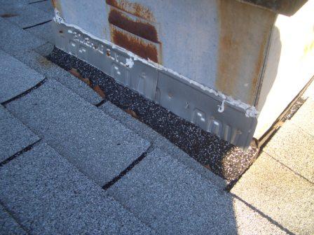

Expert shingle installation

All kidding aside, what the heck is at the peak?

Appears this may be a Mansard if so that’s flat roof edge flashing

It’s a GAMBREL roof. That’s flashing you see there.

Looks like his cousin did this flashing job. YES it is a license plate cut in 2 and caulked. I’m still not sure what results they expected to get from this world class repair job.

Nice way to send roof water right under the shingles and into the cavity below. headbang.gif
