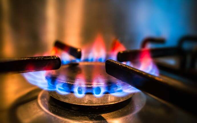

The nitrogen dioxide (NO2) levels in the outdoor space are likely fine. Indoors? Meh. That’s like a really big gas cooktop.
Most recently, a study published last December found that 12.7 percent of childhood asthma cases in the U.S. can be attributed to gas stove use. (This result was found by essentially multiplying a measure of the previously reported risk of developing asthma from gas stove exposure by the proportion of children who live in housing with gas stoves.)
And yet our grandparents (at least mine anyway) cooked on a gas stove for 70 plus years and were fine. My granny died at 93 so I don’t think the stove did her in. :slight_smile:
Survivor bias alert.
If 50% of gas stove users literally died, and 50% were fine, you could still have a gas stove survivor at 93.
