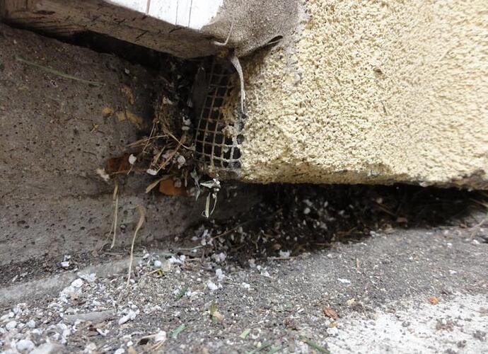

How did you determine that this is EIFS, rather than HCSS?
Barry the matter gets more complicated as it is connected mortared to a stone wall covering with lath which goes directly into the dirt if you saw my images and the foundations are totally covered .

I know from experience as the EIFS is basically a mesh over Styrofoam in so many words so it sounds very hollow and has a low density which can be told by a tap,plus there was some minute exposure not shown here as of yet…I did say more photos to come as I am the 300 picture guy remember.
This is a barrier system which should make any Inspector uncomfortable as once there is a opening the water has no where to go .

excerpt…*But how do you tell if what appears to be stucco is really EIFS, so that you can make the necessary disclosure?
EIFS is relatively light, and sounds hollow when tapped…Real stucco is relatively heavy and feels and sounds solid when tapped.*

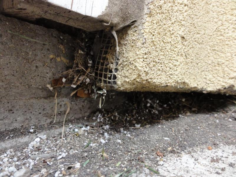

Here is a shot showing the fiberglass mesh at a door location.

[note] the styro pellets .

I can’t see why not if it’s installed according to the manufacturers specs. The main problem was that the pollocks didn’t install a weep screed, they just glued the foam board to the plywood sheeting or Tyvek and slopped some mortar over it.
I was asking because there were no indicators in your photos. Once you have experienced the difference, there is no mistaking the two.
