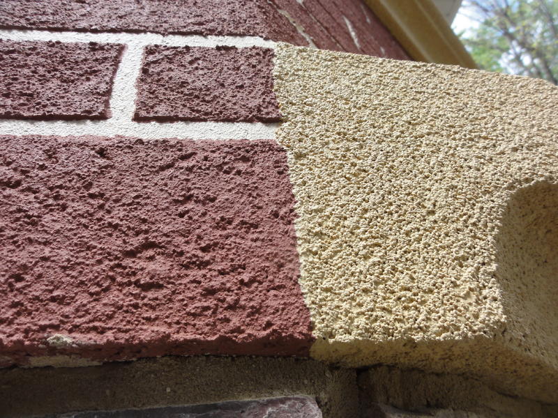

This was an interesting inspection so first let me ask you guys what you think of this exterior wall covering ?
What is it ?
Is it installed correctly?
What is it ?

It’s faux brick.
Your answer is wrong,waiting for some other guesses as this is actually something educational after a few more come in.
Nice try but no.
Will let in one more guess before the reveal as this was a tricky inspection.
First time I have seen this .
Stucco to look like brick??
No EIFS…WHAT?..yep.

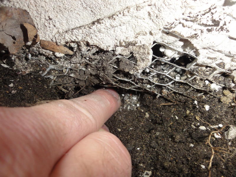

Never saw it shaped and colored like this and here is where I ask you guys familiar with EIFS and stone to look as this was combined as a barrier system and no flashing or weeps with the stone on lath and going into the dirt with no exposed foundation which by the way was a combination of 2 years old and over 100 year old stone foundation.
Gosh where do I start…here are a few pictures to get going.
Bear in mind EIFS as a exterior wall covering is rare in Chicago and I am not even sure if the barrier type is allowed.
More will follow.
[ATTACH][ATTACH][ATTACH]

StoCreativ Brick is designed to be used with drainage systems

Does that EIFS require flashing on transition to the stone which begins aprox 5 feet from grade even though the barrier method is being used here?
i advise you take the training and collaborate with eifs/stucco specialist until you know the answers
think a sec about the question, how is a non-drainage system going to drain onto and out a transition flashing?
