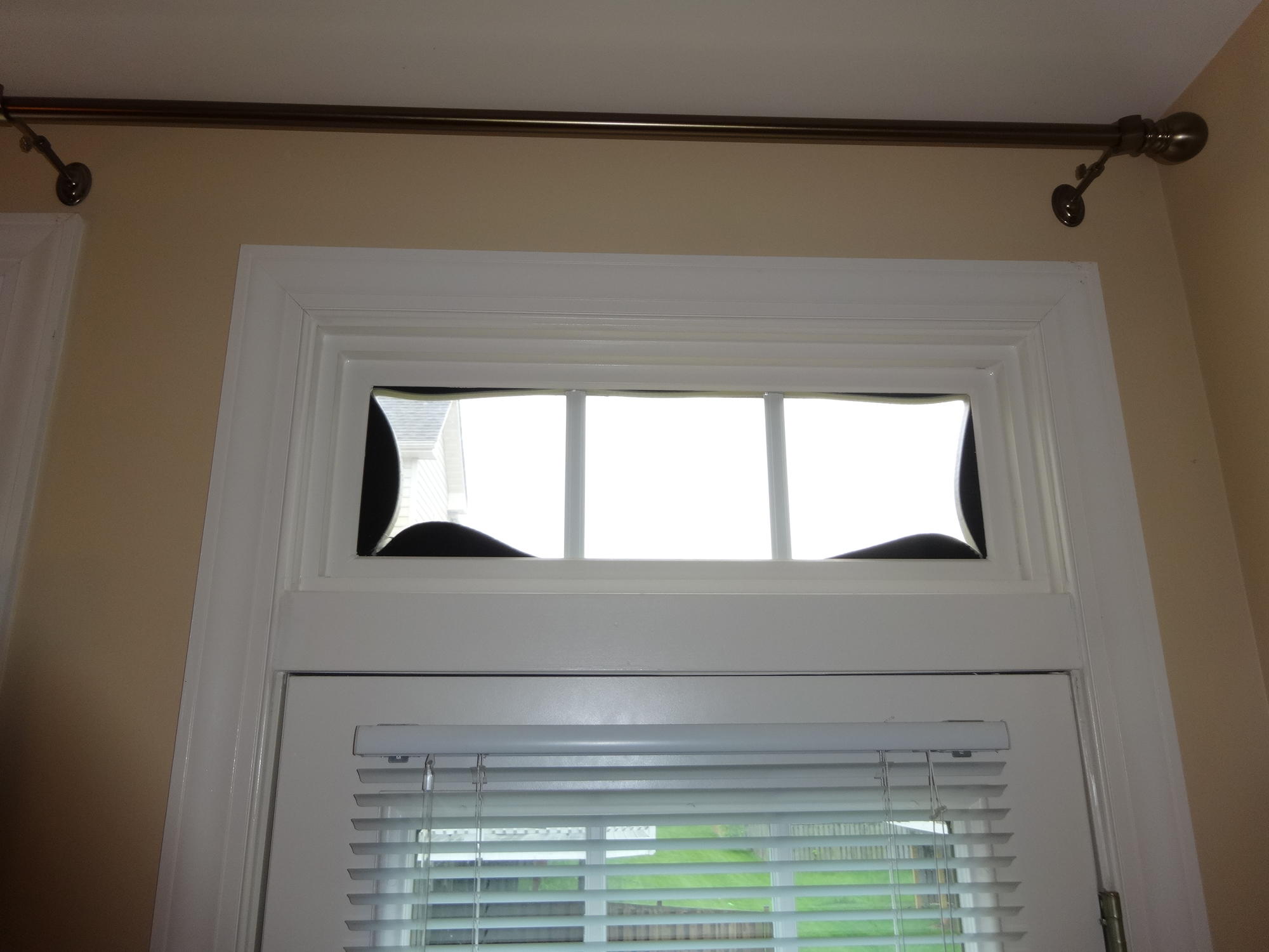

Does anyone know what causes this? I only see it on transom windows.
Looks like spacer bar and seal failure.
usually heat builds up and they pop
Swiggle seals
Thanks Robert, you don’t know how long I spent trying to remember that friggin swiggle.
http://windowworx.com/swiggleseal.htm
:wink:
