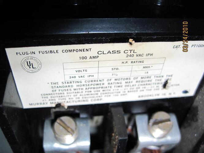

Just wanted to share.
Here in Florida that is an easy one. Replace the box, as most insurance companies will not insure fuses. That aside, looks like double taps with copper aluminum together.
Did you check under the fuses for pennies? ![]()
Not any match fuse and double taps. Regardless it still needs upgraded to breaker box.
You also might have single strand aluminum under the double tap which is even worse. It looks to dull to be tinned copper. Quite a heavy insulation for that 20 Amp feeder.

Personal Opinion as I do not agree with ESA on this matter. Fuses have caused
many fires and the result is death. If they had designed the fuse box correctly then you would not be able to install a 30 amp in a 15 amp socket. The average home owner has no clue as to the dangers of doing this. Will you blow a 30 amp fuse when running a hair dryer? You will melt the plug and cause a fire in the wall first before blowing the fuse.

Jim a normal home owner will not change a breaker but a normal home owner will change a blown fuse with anything he can find in the house. Even the well designed Copper penny on the back of a blown fuse.
Let me ask you this. When they made the fuse box did they take this into consideration as a means of protecting the stupid people?
