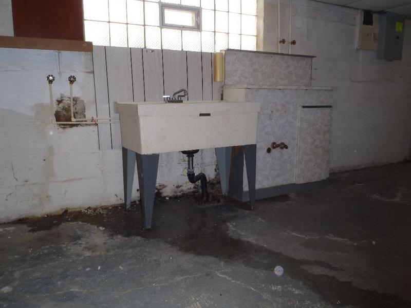

Would this be an approved fitting to use for cooper and plastic? This was leaking but it was at the soldered connection.
I think it is call a push connect, they do make them . I would just write it up to repair the leak and go on from there . Was there any more used
Yes, by the laundry. Those were leaking big time but not at the fittings.
Supposedly Fannie May fixed the plumbing, But I do not think so.
One pic is behind the beautiful cabinet concealing portions of the piping. Told client to direct that finishing to the trash.

Based on your photos alone, it’s hard to know if “approved” because no markings are visible.**

They make copper ones. They are called shark bite fittings and they sell them at lowes…
Looks like the right color to me. Clean your glasses perhaps??
I’ve got Shark Bites caps that I carry. None of those are copper like in the photo. I also don’t see the plastic ring that would be present on those or push connect. Most likely crimped like Michael said.
Micheal is probably right , I could not see to much from the picture . Lon and short it is leaking at the copper side so it will have to be replaced .

If I am not mistaken it is a copper to cpvc fitting.
It takes a special glue but it is common in Montreal home box stores.
Pex has the same type of fitting only internal and clamp, not external ( meaning out side gets glued to copper fitting. )
With pex it compression and clamp fittings.
Copper male barbed fitting inters pex and is crimp-clamped.
copper fitting for cpvc -cpvc is inserted into copper female after being glued and held for 10-20 seconds.
