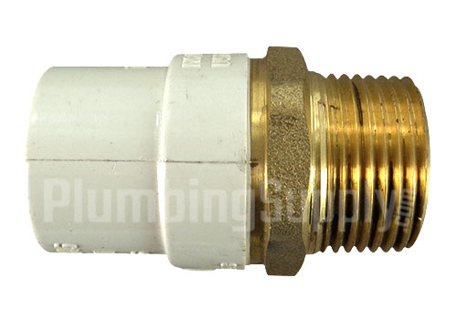

PVC-Copper-Galvanized connection???
I have not seen this before.
Any info?

WOW! glued to plastic ,New to me I do not like this in the least .
I would write this up for sure …

I did write it up, but I was wondering if anyone has ever seen anything like this before?
That is all one piece. At the water heater it needs to have at the least a rubber washer to keep the copper from touching the galvanized.
At the supply end… I just don’t know… What is keeping the connection from leaking???
I have been looking for a connector online I believe has a PVC sleeve inside the copper and looks like the one in your picture. Maybe it was a dream because I cant find it.
I would think PVC glued to copper would leak as soon as the presure hit it

there’s nothing to write up about those fittings. They are just copper water heater risers. One end has a CPVC socket to glue and the other is female iron pipe thread to screw onto water heater nipples.
http://www.siouxchief.com/Resource_/ProductMedia/299/Water%20Heater%20Connectors%20Brochure%203-09_SCREEN.pdf

If this copper stub has an internal sleeve of CPVC that crimped and sealed to the copper I see no problem with the use of this device with a compatible CPVC solvent.

It looks like the CPVC is to close to the Exhaust vent though, and possible the gas line behind it too?

This is the only adapter I have used or seen to go from CPVC to copper.
http://www.plumbingsupply.com/images/cpvc-metal-male-adapters.jpg:slight_smile:
Never use pvc in this area . It never looks safe to me when it comes to heat . And that gas line looks rather close to the vent .
That vent should not be to hot. Its a mufti purpose or duel-vent from what I see. The cpvc 90 angle is almost up against the vent.
The pipe has an inner pipe.
2 pipes in one.
The outer is for cold air for combustion and the inner is for the hot exhaust fumes.
There will be no heat issues.
The cpcv should be no problem on that setup.
