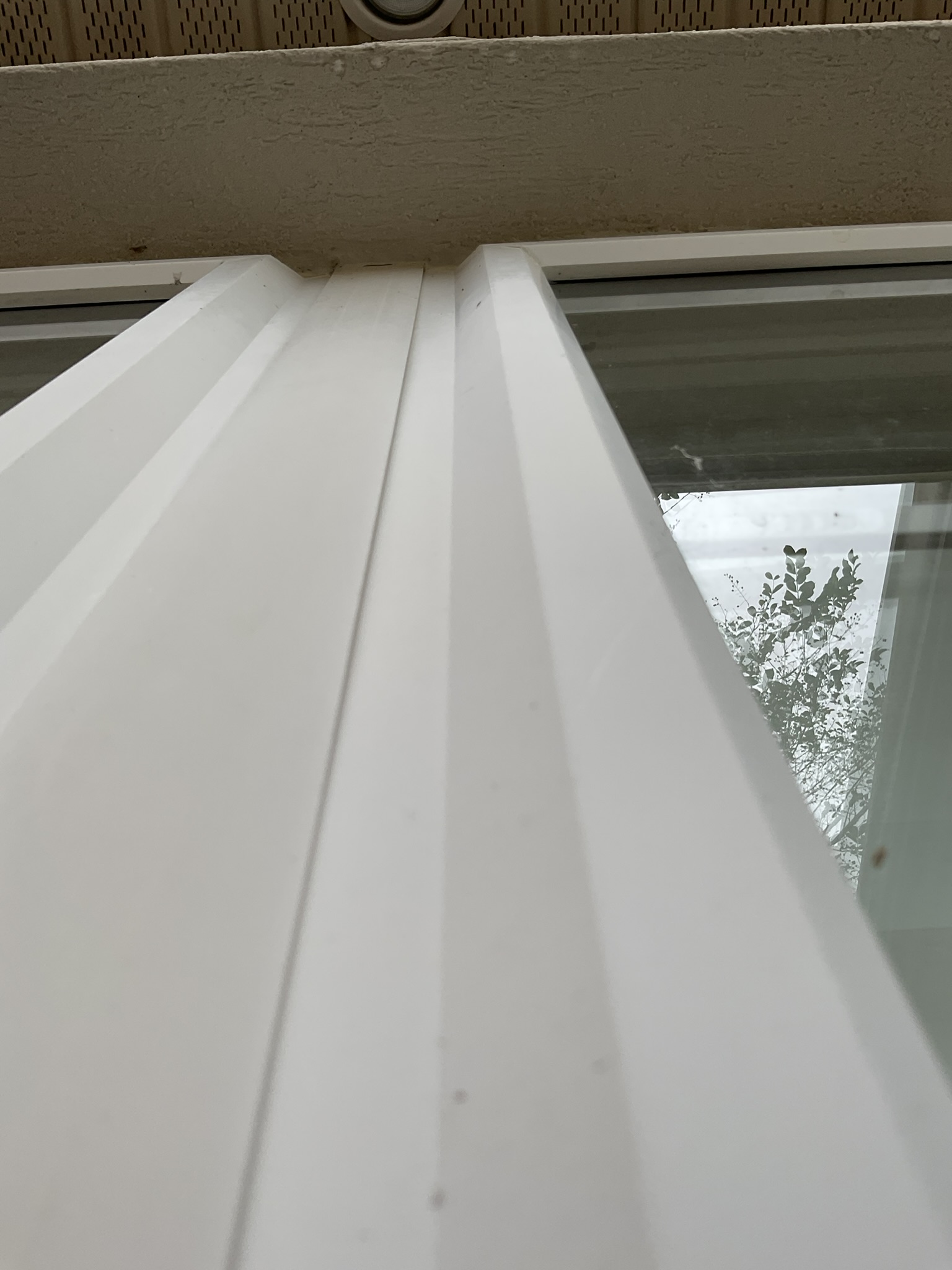

I found a an already existing topic category called “Wind Mit Window Labels” BUT CAN’T FIGURE OUT HOW TO ADD to the original post. Anyways, glad I got that off my chest…Here is a picture of my WIND MIT WINDOW LABEL. Been searching for 1/2 hour on Google and can’t find CRAP!
NAMI AAMA/NWWDA/ I.S.2-97/ASTM F 588-97
CODE: S-219-1
SPEC: H-R35/40/50
SERIES: 1900 SH
MST: 4060/3850
Does not appear to be impact rated.
Did you tap on the glass? Impact will sound like a windshield.
I don’t even look for labeling without first tapping on the inside and outside panes
