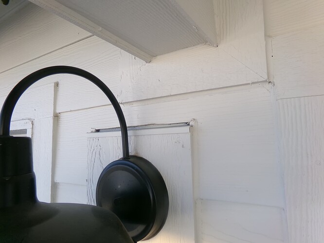

Flashing installed above exterior light
Now this is the first time I have seen this. Why use the flashing? Other than sloppy should I call this out?
No do not call it out. Is it cement fiber?
It is a block penetration. Here are examples.
yes it is hardie board. Realtor wants me to call it out but it just looks like a sloppy cut to me.
Surely you don’t report what the agent wants you to report as a way of inspecting.
Sorry about calling you Shirley.
Cosmetic issue. Let the buyer complain if the want, but it’s not a defect.
Nothing to call out other than it’s a sloppy install. I see it almost daily… Move on…
Is the REA doing the inspection???
It helps prevents deterioration. Like what you see happening at the door.
It might look a little sloppy because its not caulked, but it’s not supposed to be caulked, either.
