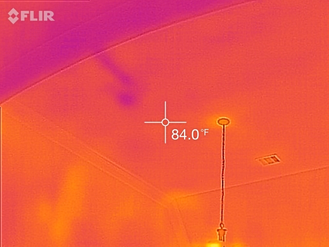

I can have a better idea when I look at the image above (With Testo), the difference between Testo and FLIR ONE is obvious. For the image below, I did see this before, but the problem is that one picture is with lamp and the other does not, so that may not be good for comparsion.

That is just the angle of view between cameras. At that distance it does not matter that much.

This would be great to do in a lab environment. I just provided you with a different images of the same area in a real environment, with real conditions, with real deficiencies that were observable with a tool and not the other gadget. I looked at my phone archives and found that I actually had a two FLIR One images of the same area. The second image doesn’t have as much of the lamp in it as the first one. However, you will notice that the it still does not capture the ceiling leaks in the background.
I don’t think anybody is debating that the phone IR cams can give results, what we are saying is the potential danger of one using a FLIR One, C2 etc… in a building envelop where deltas will be very small and chances of missing something are greater.

Thanks a lot,it is better to have images without lamp for comparing.
By the way,what is the version of this FLIR ONE?160X120 RESOLUTION OR 80X60?
