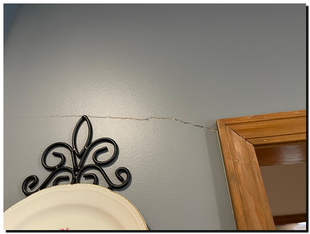

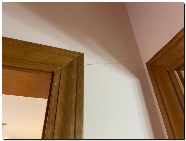

Here is a free graphic showing a typical drywall crack due to floor settlement.
Thank you Randy
Great illustrations, Randy. A most to remember when inspecting homes and you find diagonal crack at the top of door way. Pull out your torpedo level and measure if the floor to see if it sloping in the same direction as the crack above the door jamb.
