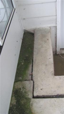

POS near Cleveland!!
Home has an inferior basement system.
Exterior all graded towards building, poor roof drainage.
Major settlement at patio enclosure, water entering basement.
Inferior basement system with 2 sumps, 1 crock full of water and discharged all the way across crawl to other crock discharge in basement. What a waste of pipe!!
I really would like to take the installer of the inferior system and dunk his head into the sump crock and ask them what the F were you thinking!!
These pics do not tell the entire story but I think you get it. You guys are intelligent.

So picture 2 pumps on opposite sides of the basement & crawl and instead of discharging the 2nd to the exterior about 3 feet away they add about 100 feet of discharge, Tee it above the 1st pump and then run another 25 feet and dump it next to the foundation so it can seep into the basement and start all over again. :roll:

Pic’s 27–34 here, see where the dumb water was entering and umm duhhhhhhhh, what was REALLY needed to STOP it, not divert it
http://picasaweb.google.com/101049034584960315932/BasementWaterproofingIBeamsEtc#
Sheeesh Kristmas, all someone needed to do was be HONEST,EXPERIENCED…and do w t f was done in those pic’s. Since ths HO’s CORNER also needed to be done(last 2 pics), if i remember correctly i charged them $50 more to do the PORCH…think the total was $1,075.
And yet the INSIDE SYSTEM smelly,incompetent TURDS charge MORE to DIVERT the dumb azz water lolol. And MANY CITY inspectors think this is just fine/exactly what was needed…pfft.
