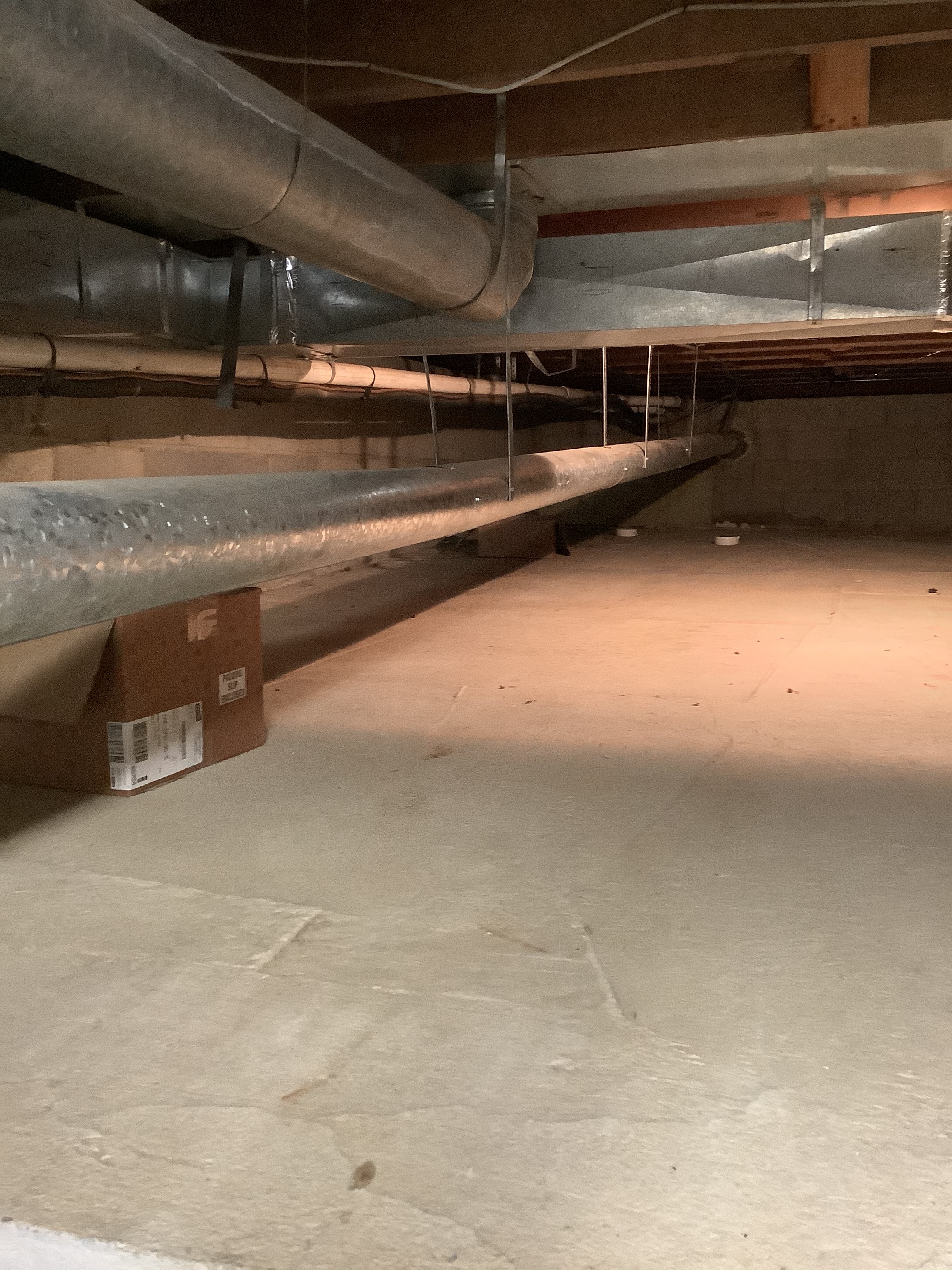

Gas Water Heater Exhaust Vent
What’s wrong with this picture?
Lack of heat traps on water heater and lack of dieletic fittings? Lol
The needle valve? :upside_down_face:

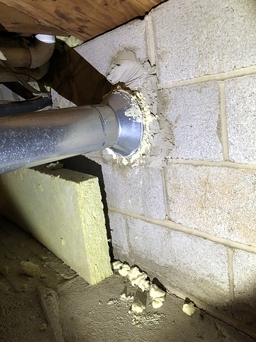

Spray foam around vent. :upside_down_face:

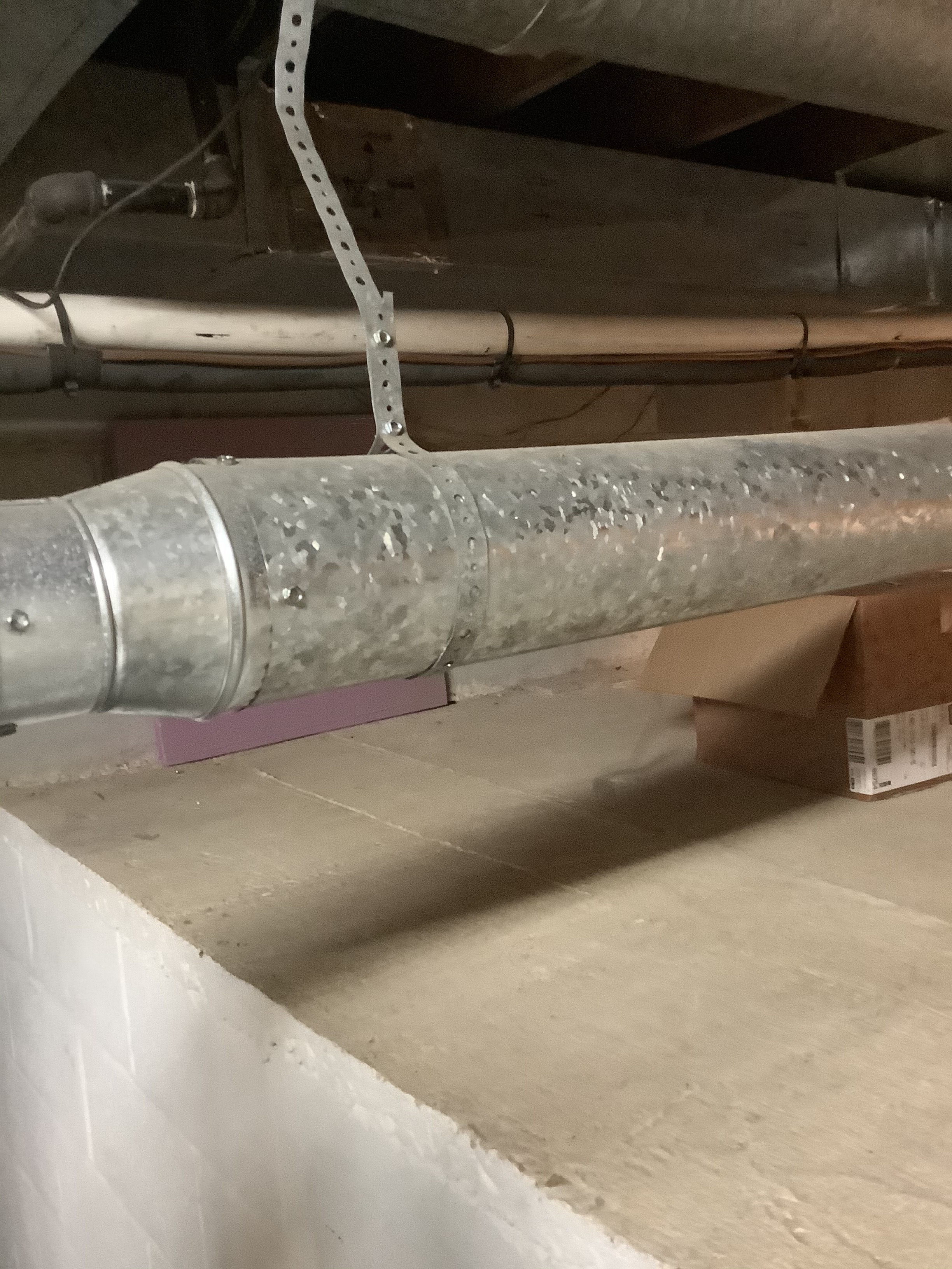

I’m not going to write your report for you. But I would like to see a positive slope.
And that vent doesn’t appear to be that in your images.

Does pic 3 anything hanging off the non metallic (romex) wiring?

It looks the NM cable just has a sag in it, Who knows.

Seriously though should we have a thimble in the wall? Or would that just be for wood?
Have to mention the cardboard :package: box
The following I found on Inspectapedia…an on Whirlpool water heater installation instructions
not 12 " rise before turning
A portion of the vent pipe (up to 75% of the total vertical height) can be horizontal, but the termination must be vertical. For the horizontal section, install without dips or sags with an upward slope of at least ¼ inch per foot. Install pipe avoiding unnecessary bends.
Is there a vertical section outside the block wall?
Is it actually resting on foam board ( a combustible)?

There could be one in there it is just a masonry hack.

That exhaust vent connector is way too long to draft naturally. Holy smokes!
