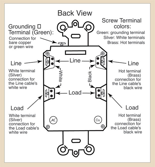

Yes … there are terminals/connectors on GFCI receptacles specifically for that purpose.
Thats okay as long as those downstream exterior/basement receptacles are wired correctly to the “load” terminals of the GFCI device, which will provide the required GFCI protection. If they are wired to the “line” terminals of the GFCI device, there would be no GFCI protection.
An easy way to check this is to press the “test” button on the GFCI device. If the exterior/basement receptacles then shut off they have GFCI protection.
