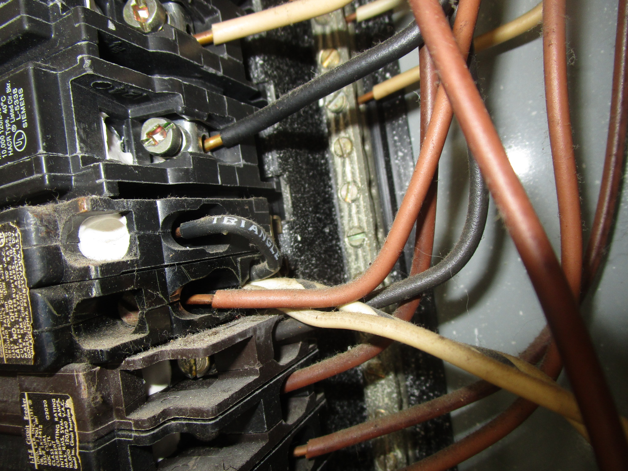

GFI Breaker installed correctly?
House built in 1980, GFCI breaker in a Gould panel. I’m not familiar enough, but not even sure it powers anything. It is labeled KITCHEN, but not sure
ITE GFI breaker installed. Black wire shown, brown wire from the circuit. 2 white wires are about 6 inches long, tied back together with a wire nut inside the panel…
Glean what you can… GFCI
(Note Robert Meier’s posts).
That GFCI breaker does not appears to be wired correctly.
This is how it should be wire, I believe (The curly white wire is part of the breaker.):
I’m wondering if someone tried to rig this so that it wouldn’t trip, or if it even powers anything. Or if it bypasses the "“breaker” function of the GFCI. With the homeowner’s OK, I pressed the TEST button, but the breaker didnt trip…Regardless, I called it out as needing replacement by a licensed electrician.
Thanks - that answers the black jumper wire question, but I was more concerned with the 2 neutral/white wires being tied together…
Nothing really wrong with the two neutrals being connected together, typically the striped neutral goes on the neutral bus and the white one is for the branch circuit neutral. I’m guessing that the wire nut is there to cover the bare ends on the conductors.
In this setup the GFCI will not provide any GFCI protection but will still function as a normal circuit breaker. Also the test button will not function. If this circuit does not require GFCI protection it can function as is.
Thanks, Robert.
Thank you Robert - I thought that may be the case - which explains that the test button did nothing. I guess it’s not “unsafe”, but is not installed correctly to provide GFCI protection. Thanks for the answer!
