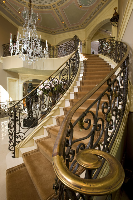

So basically you are saying you would call these out?..
http://www.ironera.com.au/assets//Iron_Work/Staircases/Grand%20Staircase.jpg
**You would be laughed out of town as a complete imbecile! **

YoYo … They TURN-BACK and DON"t stick straight out, so NO they would NOT be a call out. Guess I gotta be more detailed OR explain better.
Use your head for something other than holding up a cap.
Bob …
How about just … The shower pipe is loose in the wall. Service and correct as needed, AND lets your clients decide…
Dan, I am pretty sure he is referring to the baluster gaps .
Recheck the pictures.
Bob … Maybe you’re right. I thought he was referring to the bottom turns.
LOL ,yeah he changed it to catch us I guess.
