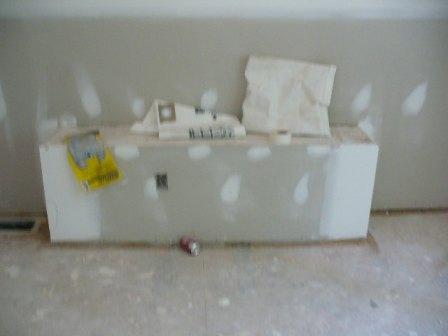

The angled framing members visible on the left side of the photo indicate possibly some kind of chase. Maybe that’s the return-air for the whole floor, they just haven’t cut the floor out yet!
I think they aren’t finished framing yet. Plans wouldn’t call for a header that size and then depend on nail shear strength. Without trimmers/jacks it has to have hardware connections to transfer the load.
I think that “angled framing member” is a temporary brace, like the one a few feet behind it, and a return air grille over five feet wide is one heck of a thing. I’m sure there’s a logical answer, but I don’t think any of us have found it yet.
Here are some updated pictures on this Header. Also, check out the finished Panels, but the rough electrical is not finished yet. Builder has a strange order of doing things.

My best guess based on the cables and wiring is that they have built a recessed shelf to hold the home theatre equipment and hide away all the cables and wiring, leaving a nice clean look with just a large flat screen TV hanging from the wall. Just a guess.
Ken - maybe I’m more dense today than usual, but the header still doesn’t make sense to me. The built in bench is cool, but why the header 20" off the floor. Didn’t get a chance to ask?

Those top cripples… they were supposed to be bottom cripples. Dumb framers installed it upside down. That’s a sill assembly with a header which was supposed to be installed against the top plate. Framers typically cut the 2 trimmers to fit between the bottom of the header and the top of the sill.
IT IS NOT A HEADDER…
It’s a built in bench the “header” is for nailing purposes. That’s my guess.
I tend to agree with Kenton, I think it was supposed to be a recess for the entertainment center or perhaps a recessed Bookcase, because it is in the Greatroom. Maybe one day, the owner will return my voicemails, and I can ask him.
I still stick with entertainment unit because I don’t think you would install an electrical receptacle in a bookcase.

It doesn’t matter whether the member is seven feet off the floor or eighteen inches off the floor, if it spans an opening in the framing, it’s a header.
I still cannot imagine the purpose of the pictured assembly…the more work that gets done on it, the odder it seems.

Just ran across this old post without a final answer so, Ken, if you are out there, was there a reason for the header located here and was it truly a header, intending to transfer loads across the 5’ opening?
Also, it sounded like you were just doing a draw inspection for the bank, just noting that a certain percentage of the line item has been performed, without the necessity or responsibility to comment on the acceptability of the work? (Is that the way these type of inspections usually work? Anyone?)
