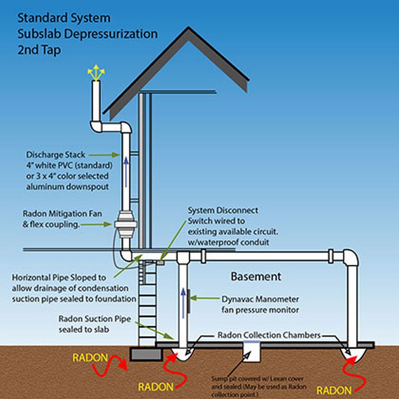

Yep radon system.
or maybe not…
Radon mitigation system. And what makes you think they were duped? On older homes they’re often not installed until someone tests for Radon and gets high levels. Usually they test during real estate transactions and once a seller finds out they have high levels they’ll almost always pay to put the system in.
Additionally, they’ll be multiple factors that can contribute to high levels, tightness of home, slab condition, etc. I’ve had numerous instances where homes right next door to each other tested significantly different.

Nice pic Jeffrey, good one for example in reports. Thanks.
My daughter bought a house in 2002 with a system like that, installed when the sellers bought the house in 1998. That was the way they installed them back then, and no one had it updated. More than likely the same deal with this system…installed about 15-20 years ago.
And are still installed that way today… (depending on conditions within the home itself), but most all systems installed AFTER the home is built are installed this way.
I have recently seen box fans vs those round ones. But, you still need a fan, a pipe and a path to above the roof line.
