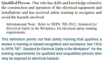

So are you saying that it is a “Risk” to a person when removing the panel cover?
I am not saying that - Schneider Electric does. I consider them to be experts on the subject. I also believe that their knowledge of electrical panels is second to none.
I am assuming an energized panel.

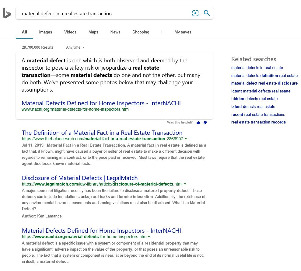

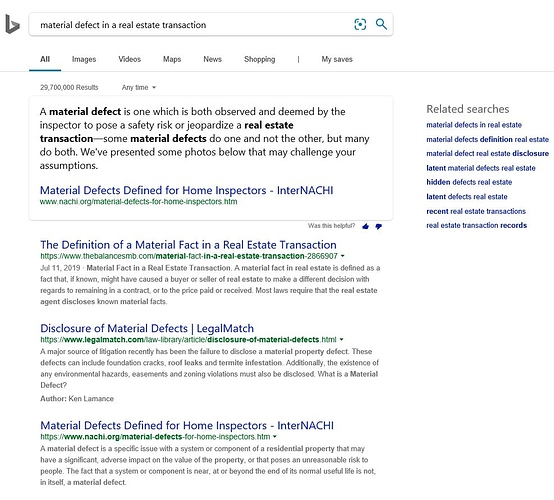

Jim - I am not saying that you should not call it out. All I am saying is that it is a ‘code violation’. It is not a material defect. At least as defined by any source that I can find.
By the definition posted it is a material defect. It poses a safety risk which is why the code article addresses it.
Let me ask this. Do you call out a white wire on a breaker? If you do, please tell me the hazard. It is only an issue to someone without the training and skills to know what they are looking at. It will continue to operate for decades safely. The same cannot be said for two neutrals under one screw terminal.
I also do not see how you can use a code definition to define a term in a legislative document.

Thanks Jim you proved my point. There is NOTHING that says that two grounded conductors under a single lug won’t work for years. It’s a code violation. NOT a material defect.
Who says that a white wire (re-identified) is a defect?
