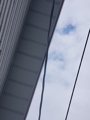

What are the required clearances for overhead wire horizontally from a roof? I know the vertical clearances. This line is less than a foot from metal roof.
No problem, no horizontal clearance requirement (only from where people can reach it, like a window). Unless it’s rubbing against, no problem. The messenger cable tension will prevent it from flapping in the wind unless it’s in the middle of the run.
It looks pretty solid thanks!
