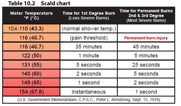

Here’s why you ignore energy economy and pseudo science, and just give your client the actual Useful information…
PHOTO ATTACHED image
Where the hell’s the fun in that??
