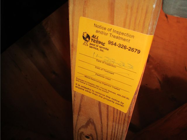

Here’s the format for notice of inspection - get 'em printed out soon! :grin:
WDO notice AT
WDO/WDI is very different in different regions. In Oregon that inspection in generally included with the HI. Most inspectors are (or should) be licensed through our Dept. of Agriculture but there is essentially no enforcement as lender don’t check our licenses. Many other areas the “termite inspection” is performed by another party and I assume there are licensing laws, rules, etc.
