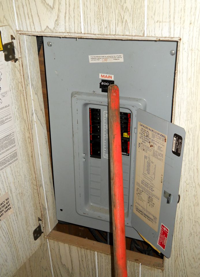

How to fix a FP Main Breaker that will not stay on...
Just put a friggin’ broom handle under it…
Man Oh Man!
Today’s inspection.
Nice!
Just figure, the broom handle is cheaper than the electrician :smiley:
Wow! Idiots everywhere!
Roy the breaker was tripping for a reason? Is that a trailer?

Good catch Marc! Yep! A Shakey Shack.
That was the way I found it.
However …
Even if it was blocked it …“would/should” have trip with over current.

Thanks Roy, I teach a class at the RE board on “Understanding Home Inspections for Realtors” and I have a couple slides on FP stabloks and that one will be a hoot!
And by the way, no I don’t demonize those panels/breakers.
You can’t “force” a breaker to remain in the closed position. They have an internal trip that will open the circuit despite the position of the handle.
I think there’s probably more to the story.

Yep! I said that in a previous post.
“Even if it was blocked it …“would/should” have trip with over current.”
It just will not stay in the on position.
Agree, that was my first thought. That broom handle is, or least should be doing nothing as far as keeping the breaker from tripping.
It will not stay on without the broomstick
It’s amazing those “What the heck were they thinking?” moments. Always more to the story, I guess one of the first reply was accurate. “cheaper than an electrician”.
