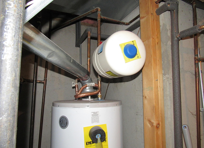

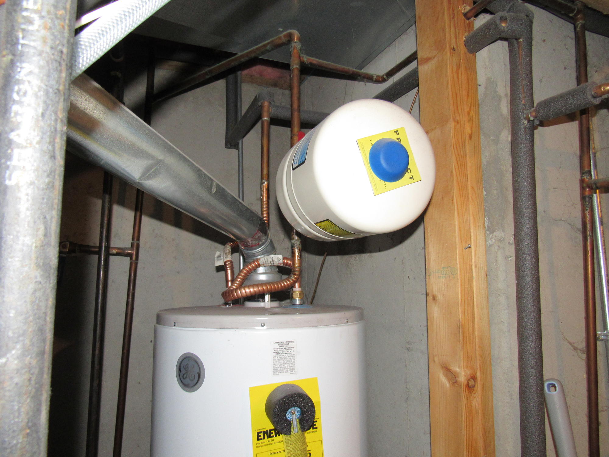

A horizontal expansion tank that is missing the support strap.

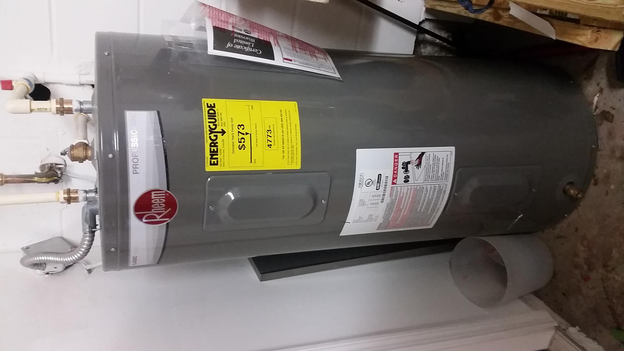

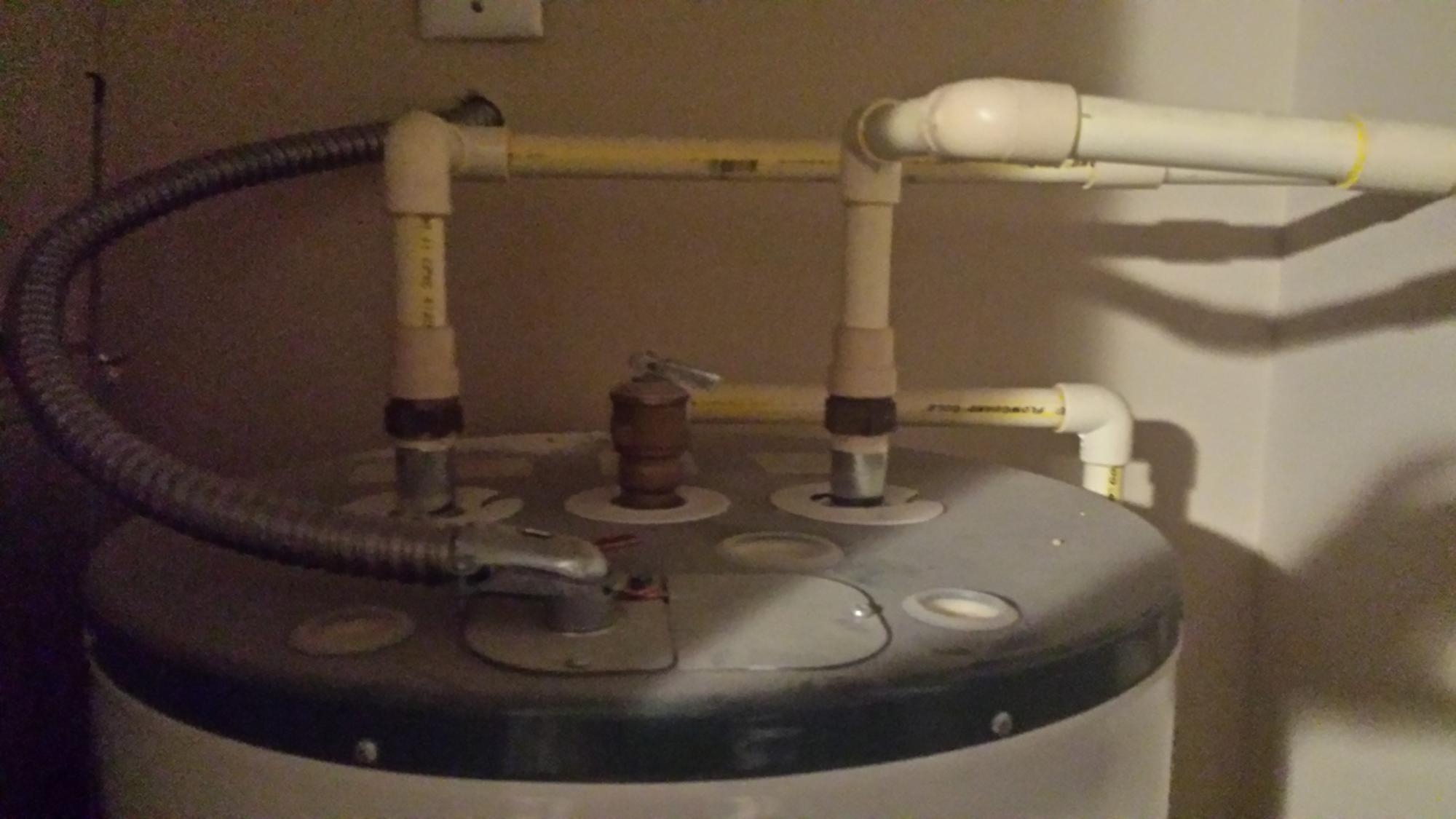

This shows an electric water heater in a florida home. Everything is in proper working condition. The tpr valve is located on top of the unit and is lead through pvc piping to proper drainage. The water shutoff valve is present with a ball valve. The drip pan at the bottom of the unit also is lead with pvc piping to proper drainage.
This shows an electric water heater in Florida. The TPR valve is attached to PVC piping that is extended and pointing straight down. Also the shut off value is close to the water heater and very accessible. This water heater also contains the correct labeling and shows no signs of defect.

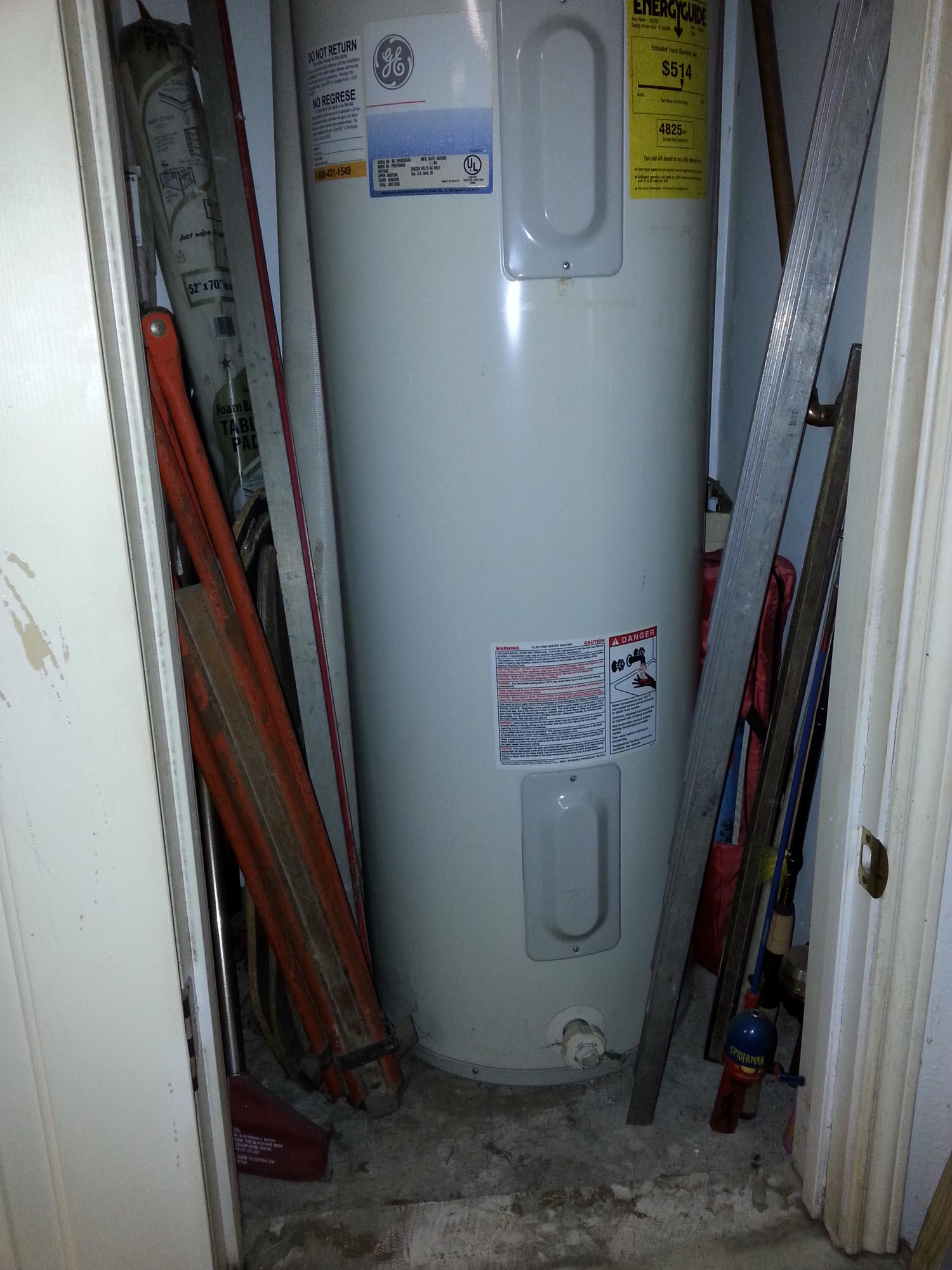

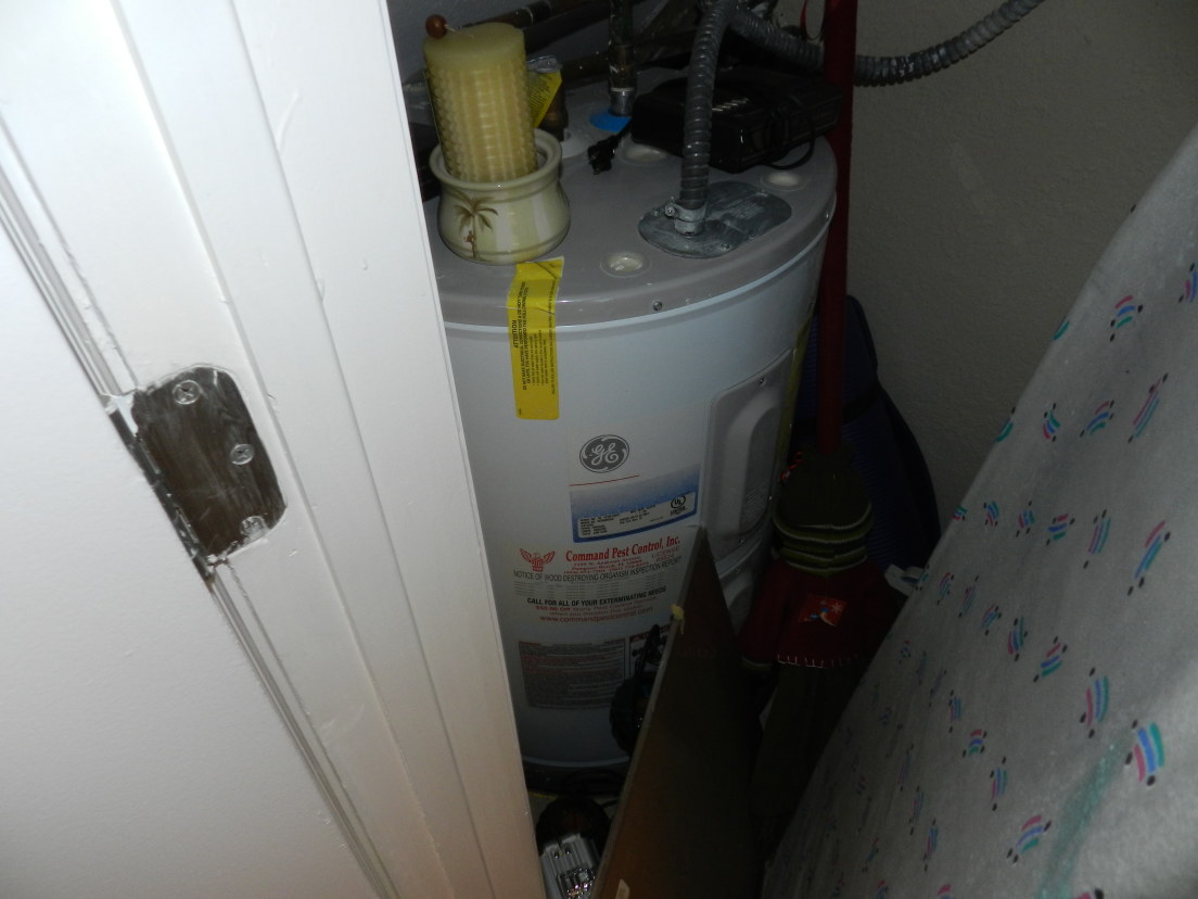

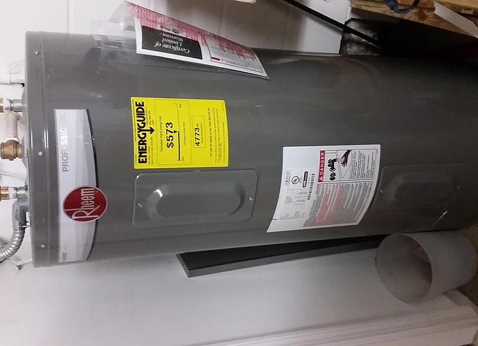

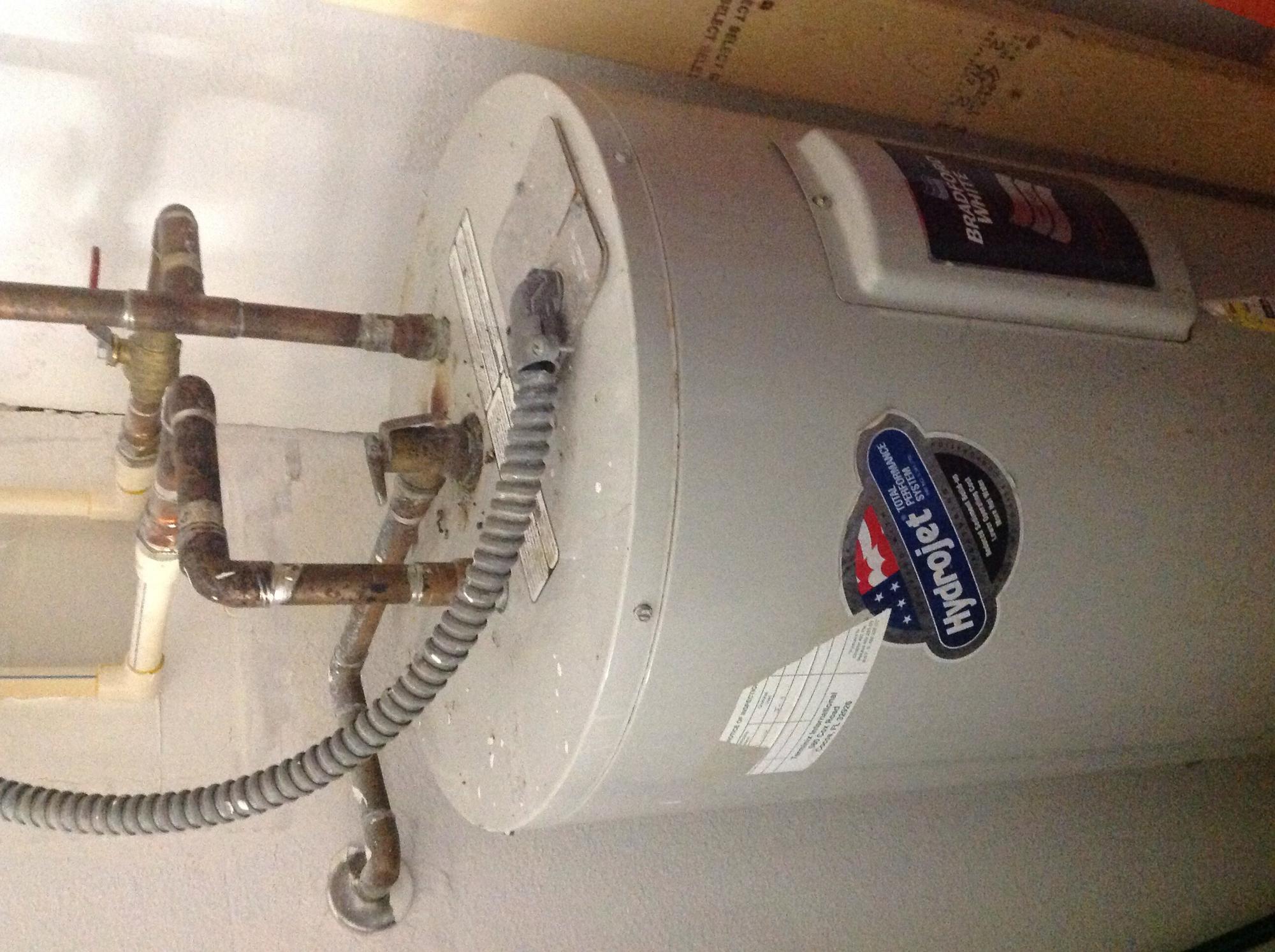

The electric hot water heater is approximately 6 years old. It is located in a garage closet and elevated 18 inches from the floor. It is deficient in the fact that it does not have drip pan at the bottom and drained to the exterior.

Pressure expansion tanks are a cylindrical tank mounted to the cold water side of a tank heating system. They can be attached to the system either vertically or horizontally, but if horizontal they will require additional support to prevent pipe stress. This tank has a bladder inside to help with water expansion in a closed water distribution system. They hold two to three gallons of water and pressurized with about 40 PSI of air pressure.

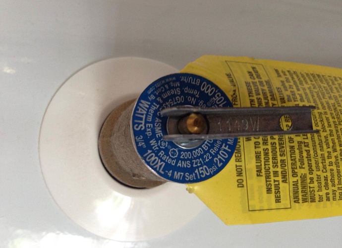

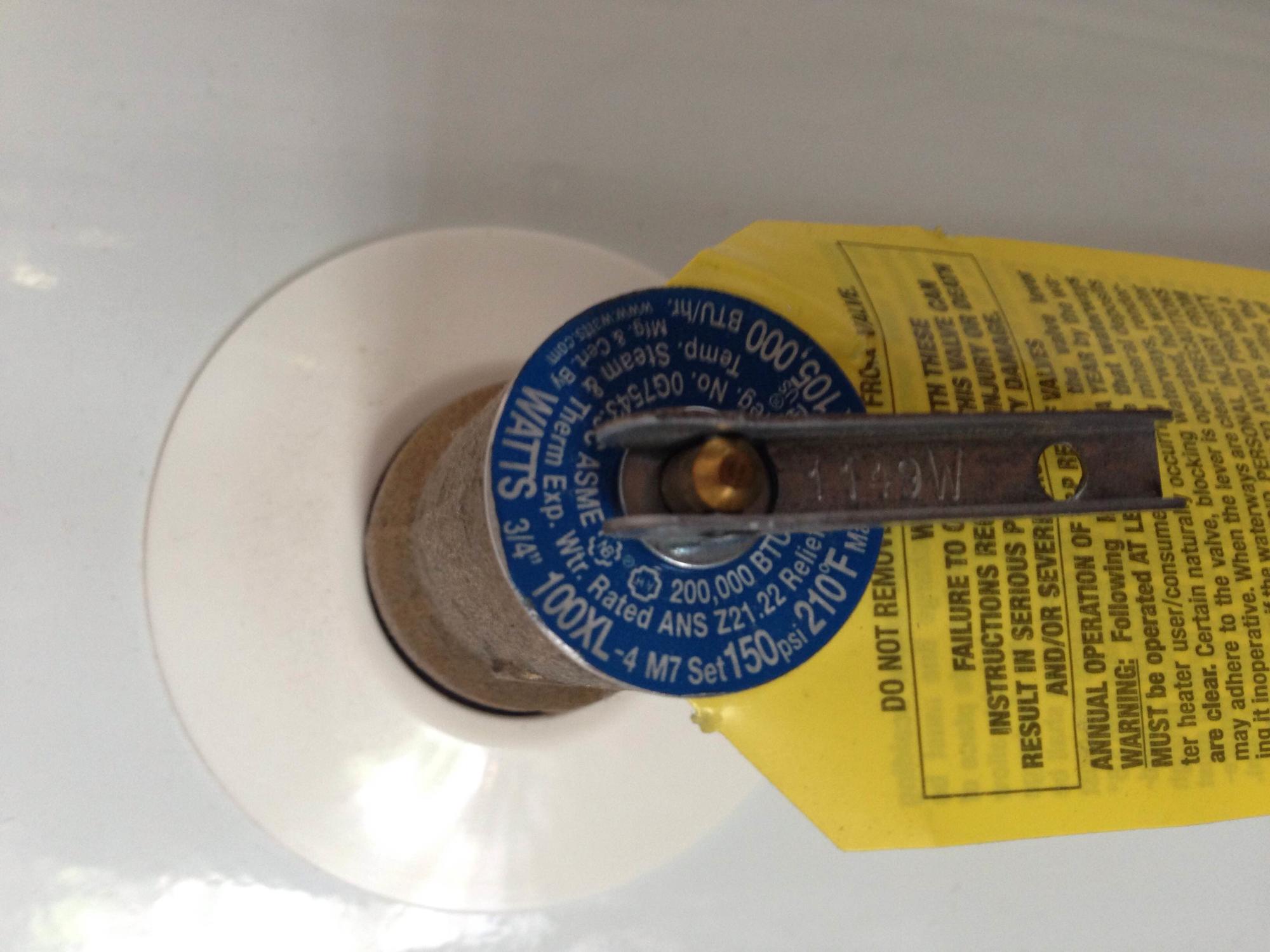

Below is a photo of a TPR valve . The valve is free of corrosion . The valves label is still intact and readable. The valve is installed in the top 6" of the tank.

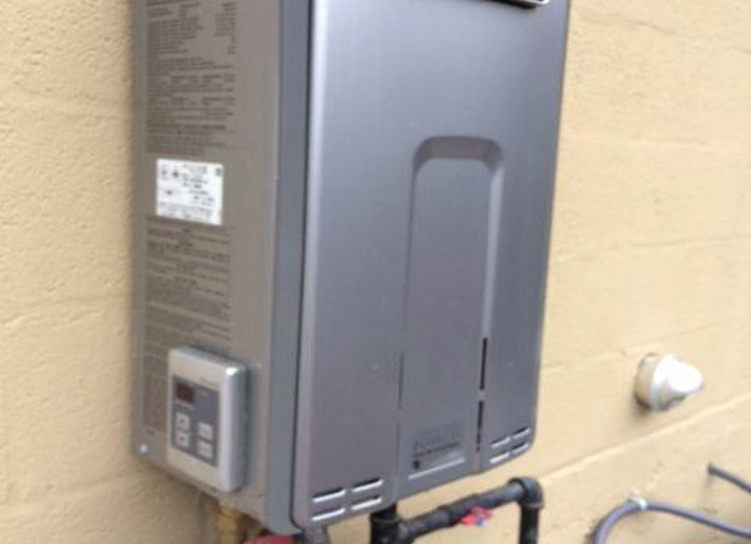

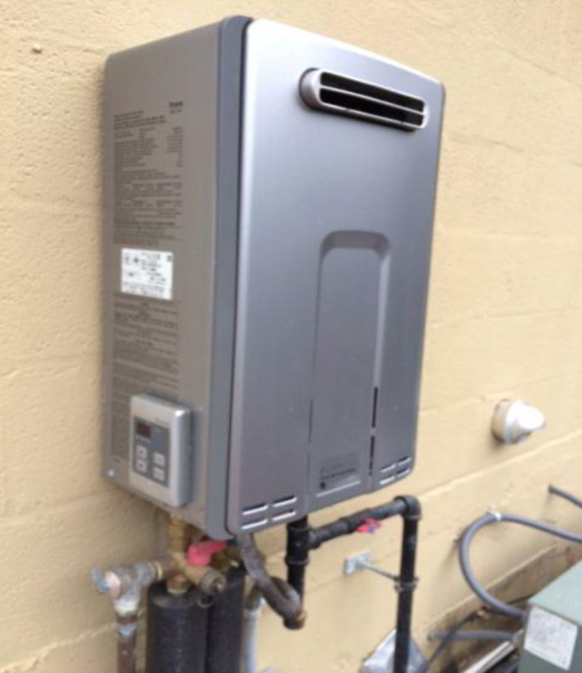

Here is the tankless water heater a the exterior of my building. The energy used is natural gas, and it appears to be in good condition.

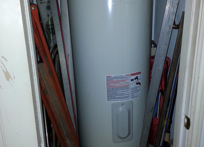

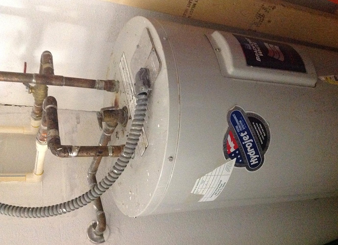

For an image I took a picture of a hot water heater in my house. Upon taking I realized that the TPR isn’t draining to a conspicuous place. In fact, I can’t find where it terminates but believe it goes outside. It’s night time so I’m not going on an expedition mission. I will tomorrow though. There is also no catch pan. Ugh! The inspector I had didn’t mention either in his report. I wish I would’ve taken this course earlier.
Based on what I have learned from this course I would have listed serious concerns on my water heater. The TPR valve is piped to un inconspicuous area. There is no catch pan. The age and other pertinent information isn’t readily available on the hot water heater. There are no obvious leaks or corrosion.

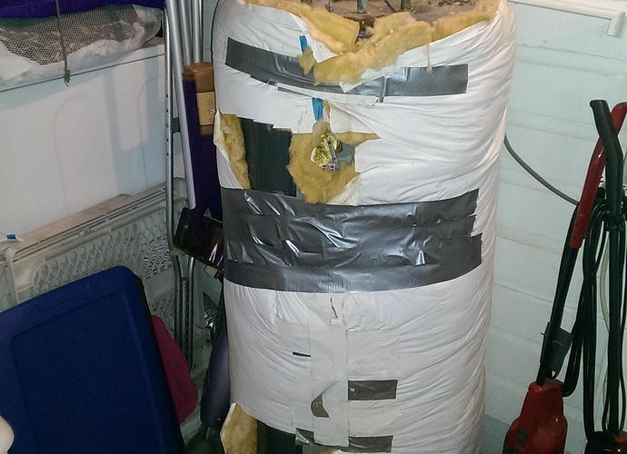

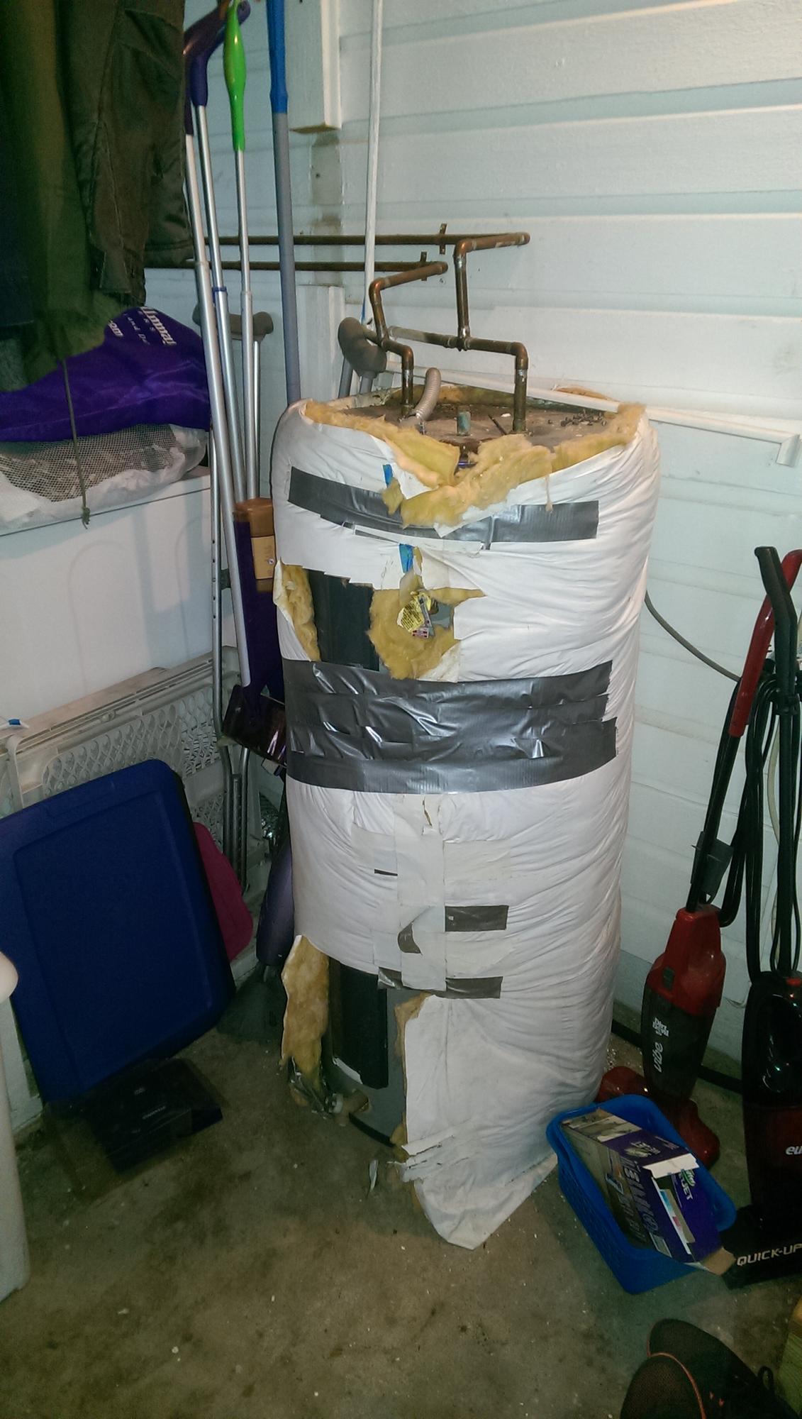

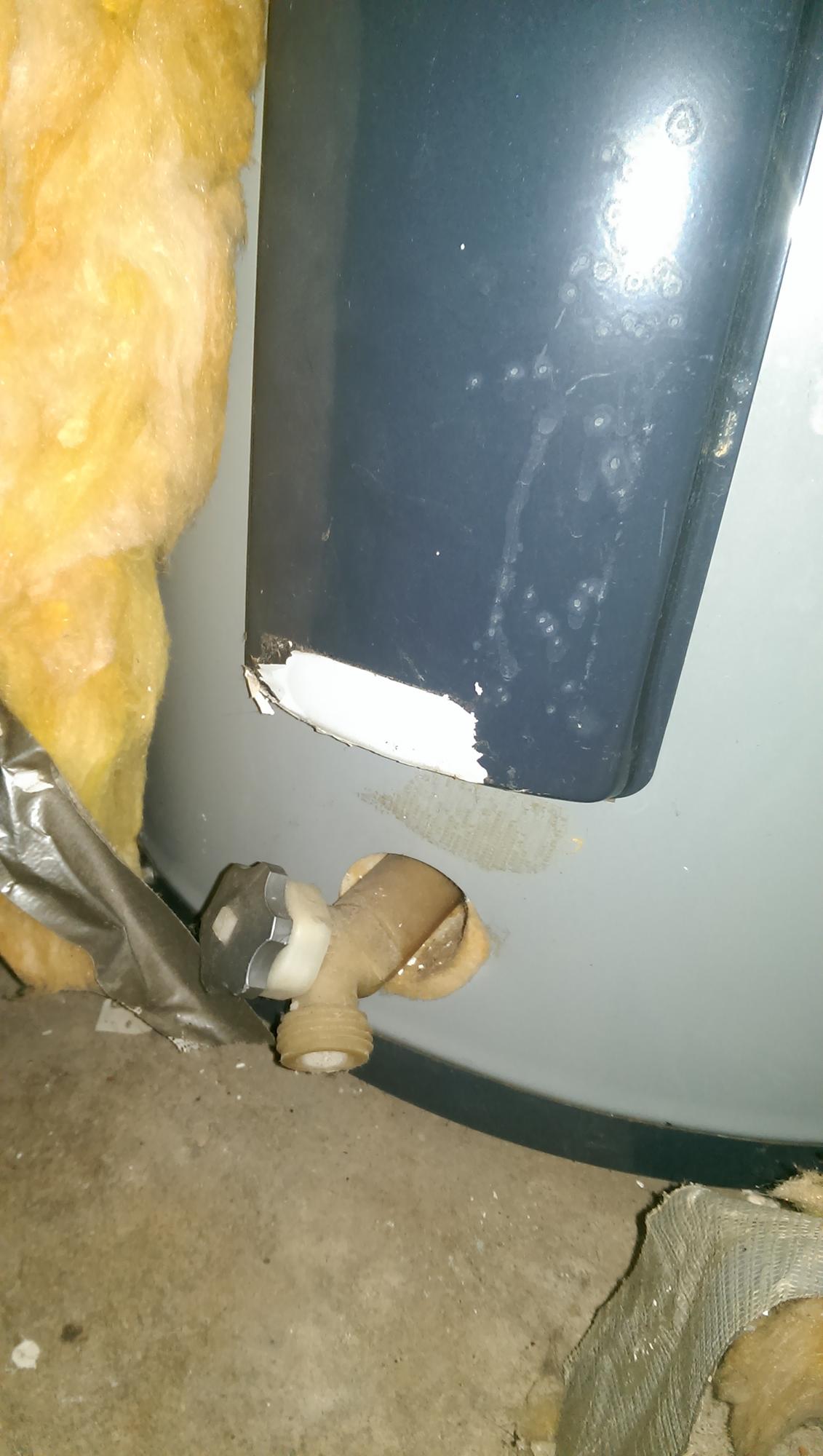

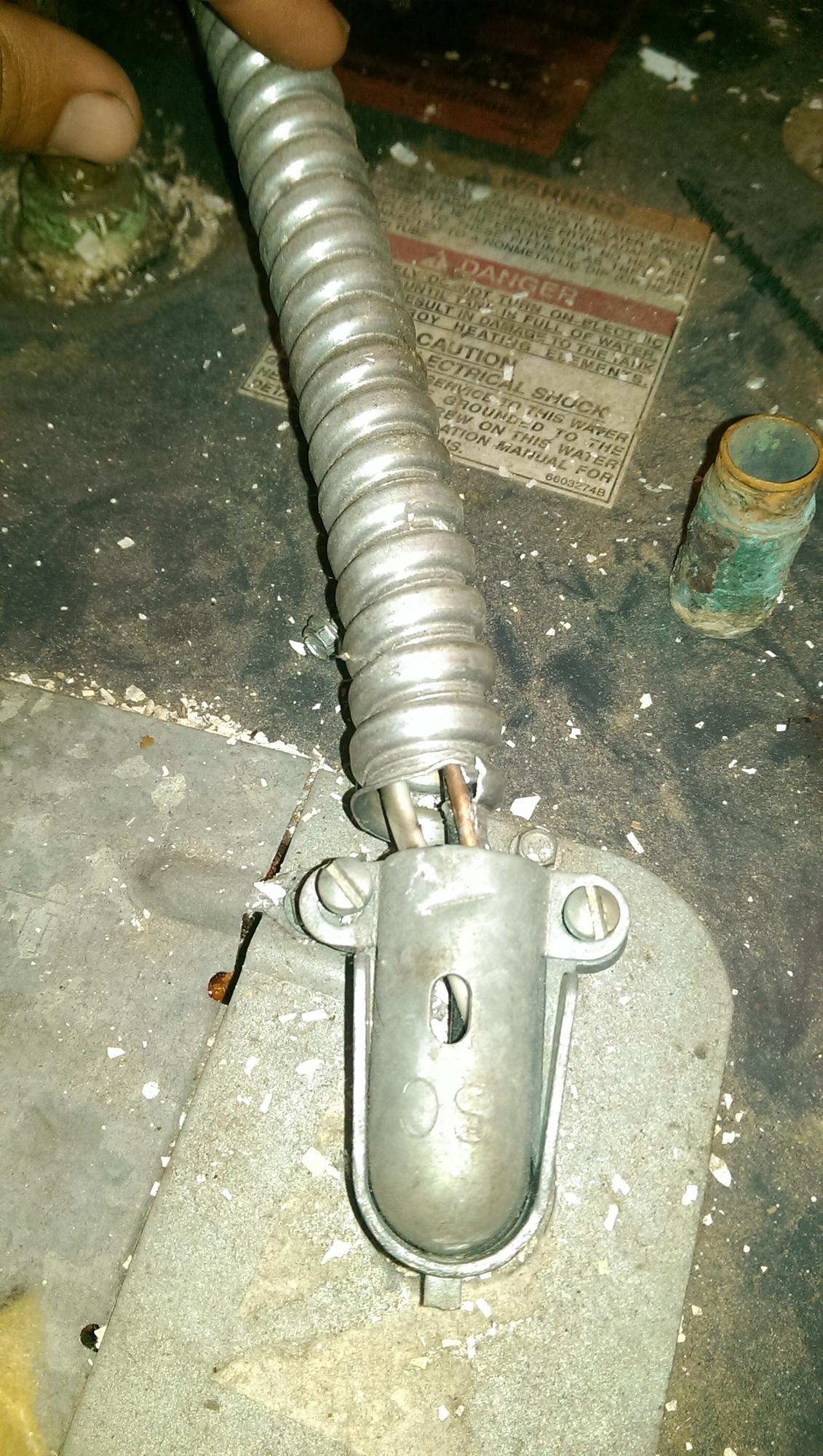

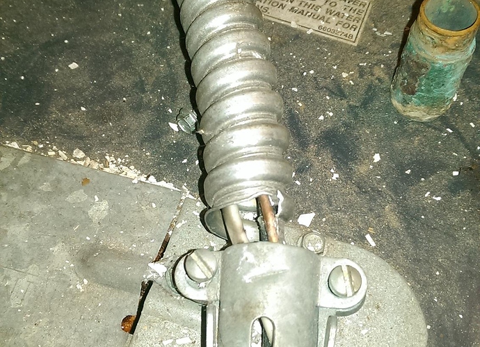

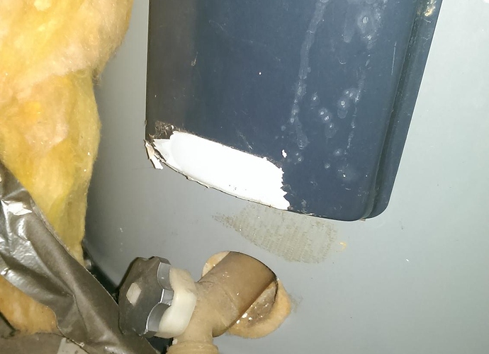

The hot water heater I inspected is located in the garage. it is an electric water heater. Covered in insulation, had to remove insulation in order to see water heater labeling. This heater has a lower quality plastic drain valve. Also found exposed wiring on the incoming power conduit.

No expansion tank but there are air chambers above.

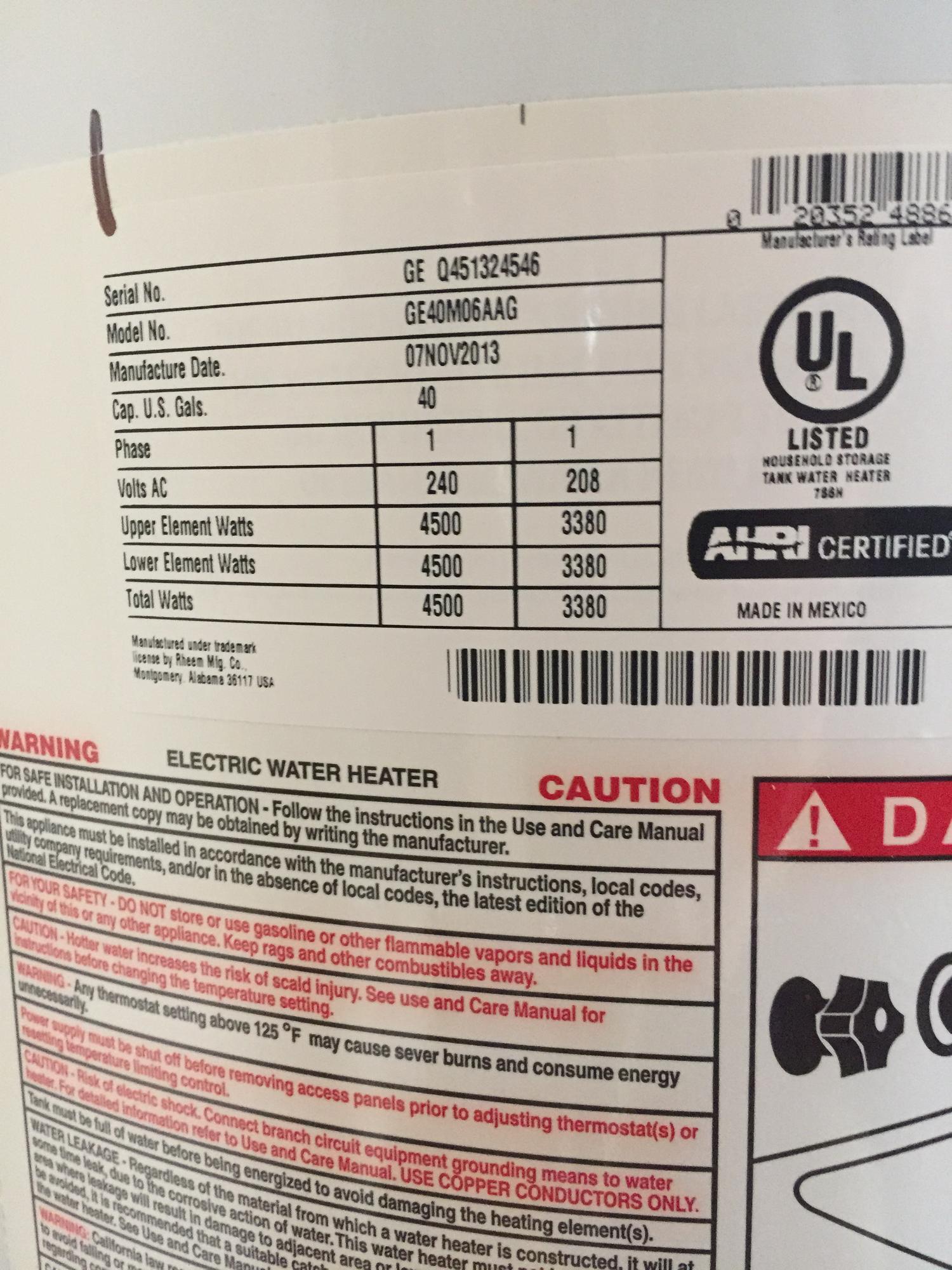

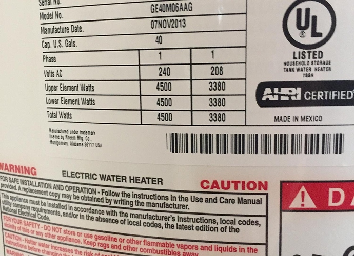

2013 GE electric 40 gallon water heater(flammable vapor ignition resistant-FVIR) with a 500,000 BTU per hour 150 psi-210F rating. There are no leaks or rust detected. all components including the TPR valve and drain pipe are installed according to modern building standards.

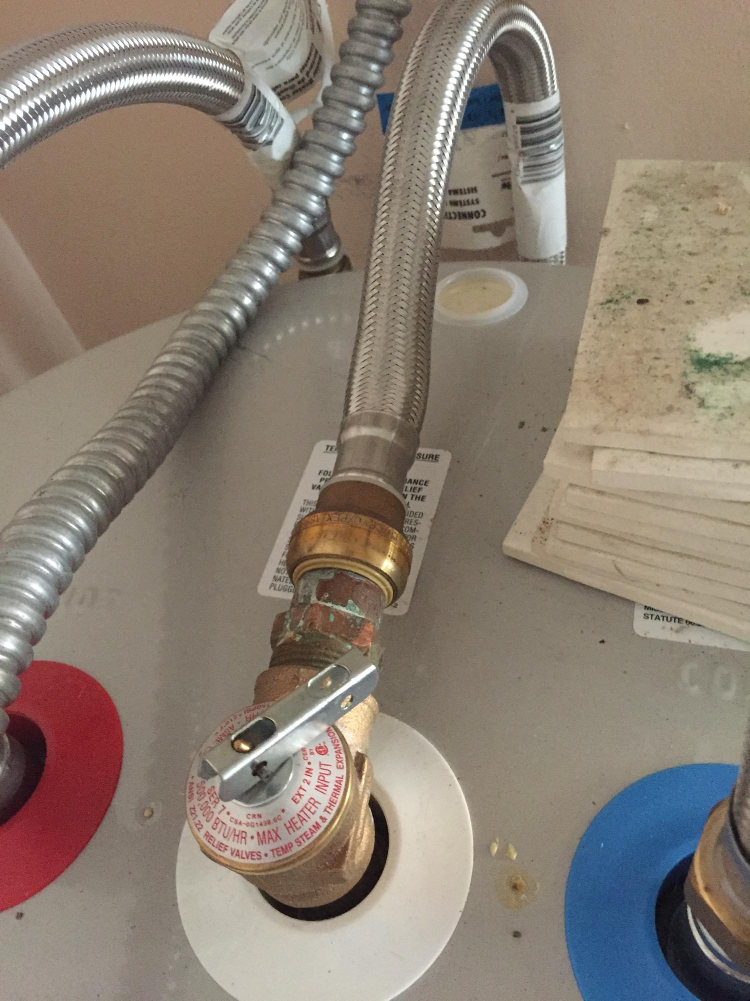

Description: 2013 GE electric 40 gallon water heater -500,000 BTU per hour 150 psi- 210F rated with FVIR(flammable vapor ignition resistant).

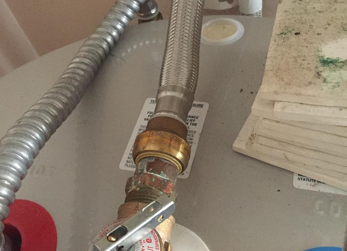

Report : The water heater is located in the residents garage on a concrete slab 8 inches above the main slab of the garage. There are no signs of leaks or rust. The copper piping connecting the water heater to service is connected using Shark quick connect connectors to braided metal flexible piping(this may indicate an installation by the home owner). There is also a remote electrical service interrupter installed by the local electric company to save on electricity consumption. All components show no damage and are in compliance with modern building standards.
Recommend: All though there is no sign of leaking at the piping using quick connectors I would recommend a qualified plumber inspection.
