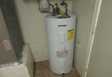

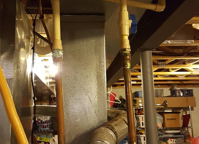

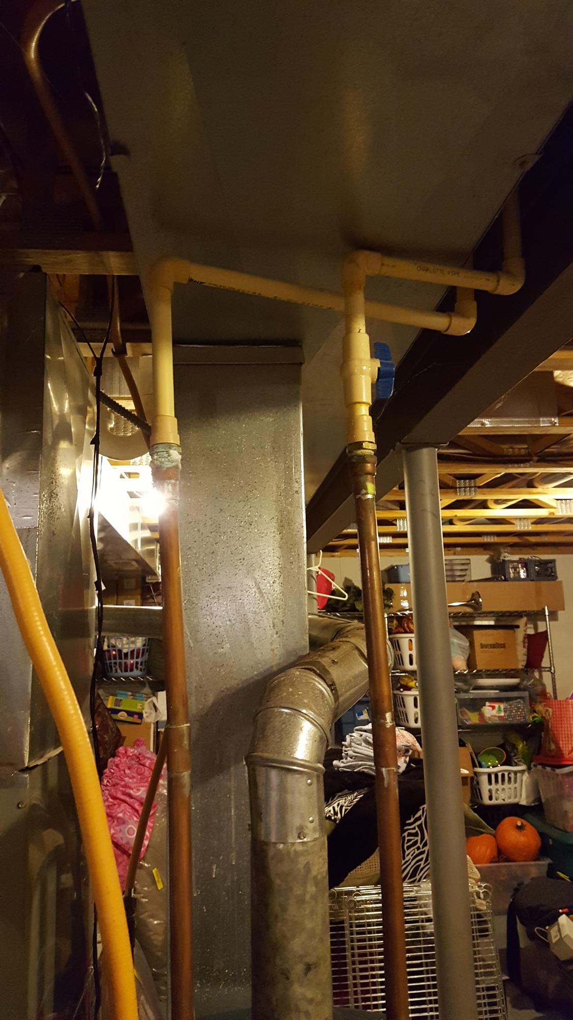

I took a picture of a water heater from my friends home. First thing I notice from the beginning of my inspection is that the water heater has a direct connection to a 240 volt, it does not have a the minimum 30amp breaker and it does have the TPR valve on top. The bottom of the water heater has the drain valve but does not have a water leak catch pan and the room does not have a draining system. This is system is electrical and had the water shut off valve on top of the unit. All the electrical was extremely close so any leak can damage or short out the electrical.

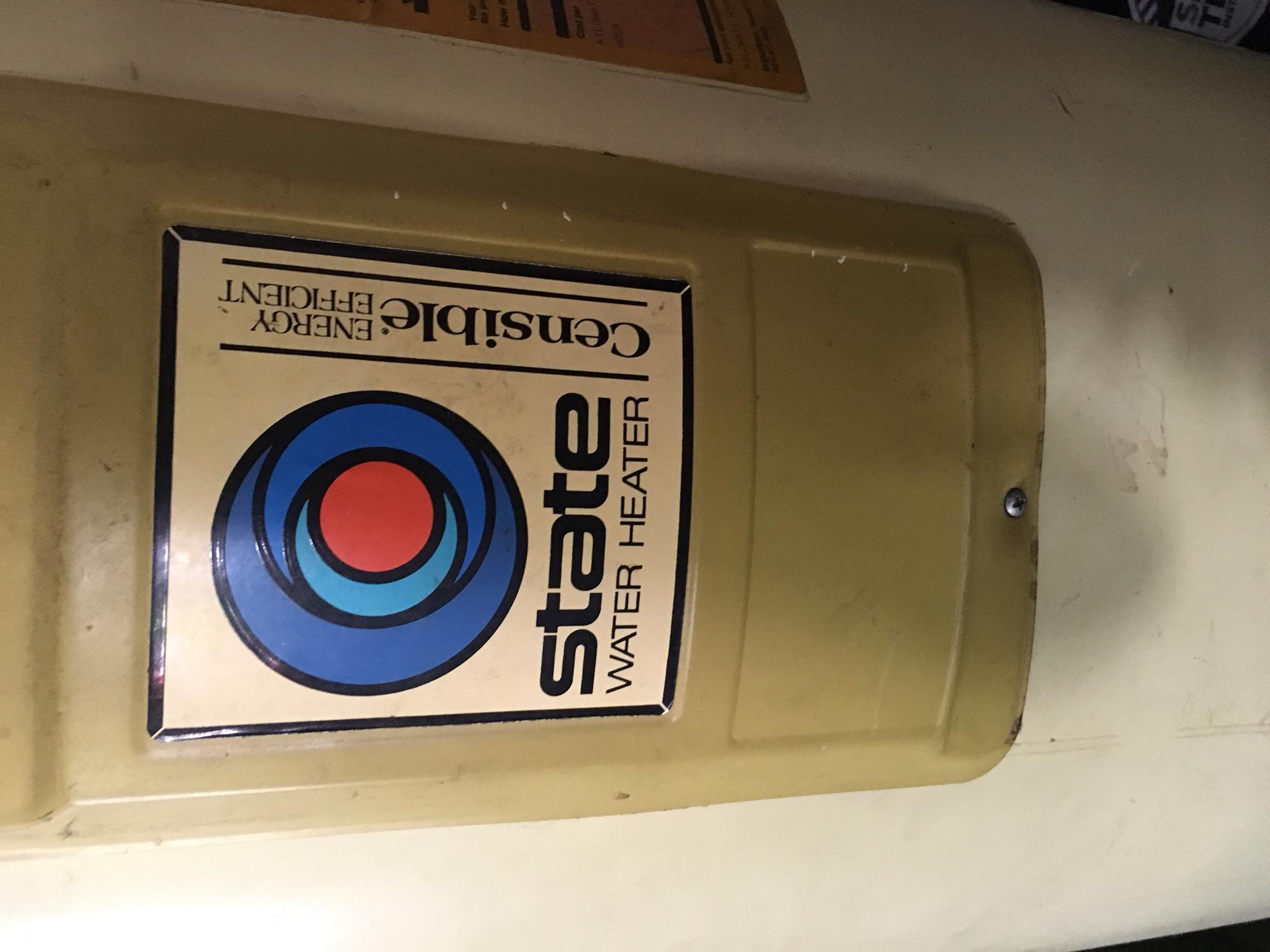

This a mid 80’s water heater that by exterior inspection/observation. This water heater although appearing dated works very well. Hot water reaches needed temps in normal time frames.

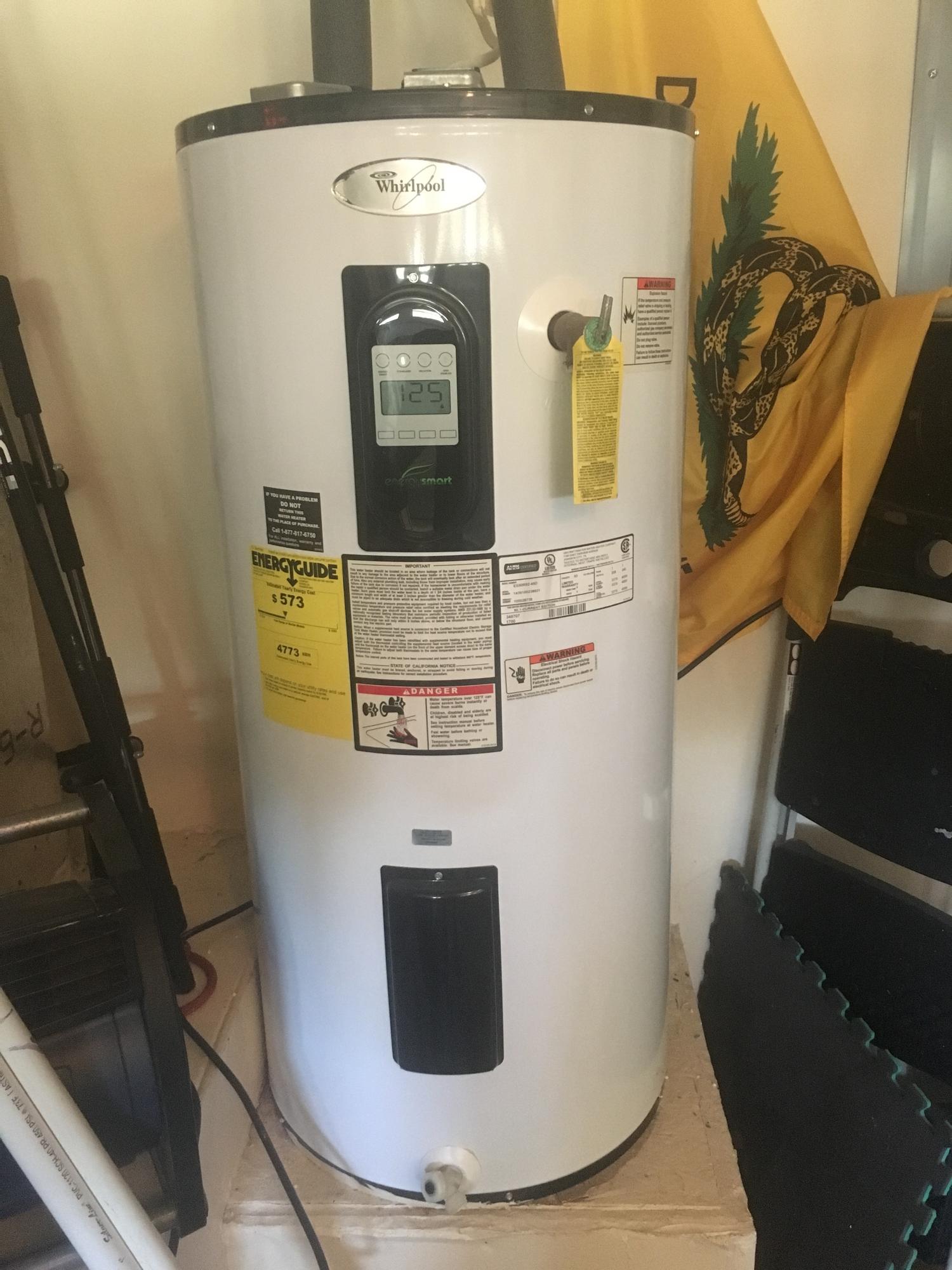

This is my home’s hot water heater. It is a 50 Gallon, Electric Water heater that I believe was built in 2014 (based of the serial number and no other date markings). The two glaring defects are that there is no piping attached to the TPR valve for proper termination and there is no drip pan under the water heater itself. Adjacent to the water shut off valve above the water heater there is signs of previous water leaking and corrosion. Further inspection appears as though this occurred in the past and is not a current problem. The cap of the electrical connection on top of the water heater was left open which poses a safety hazard. It is obvious that this is a newer type of water heater due to it’s digital display and a convenient “vacation” button which would stop the continuous heating of water if our family was to leave for an extended period of time.

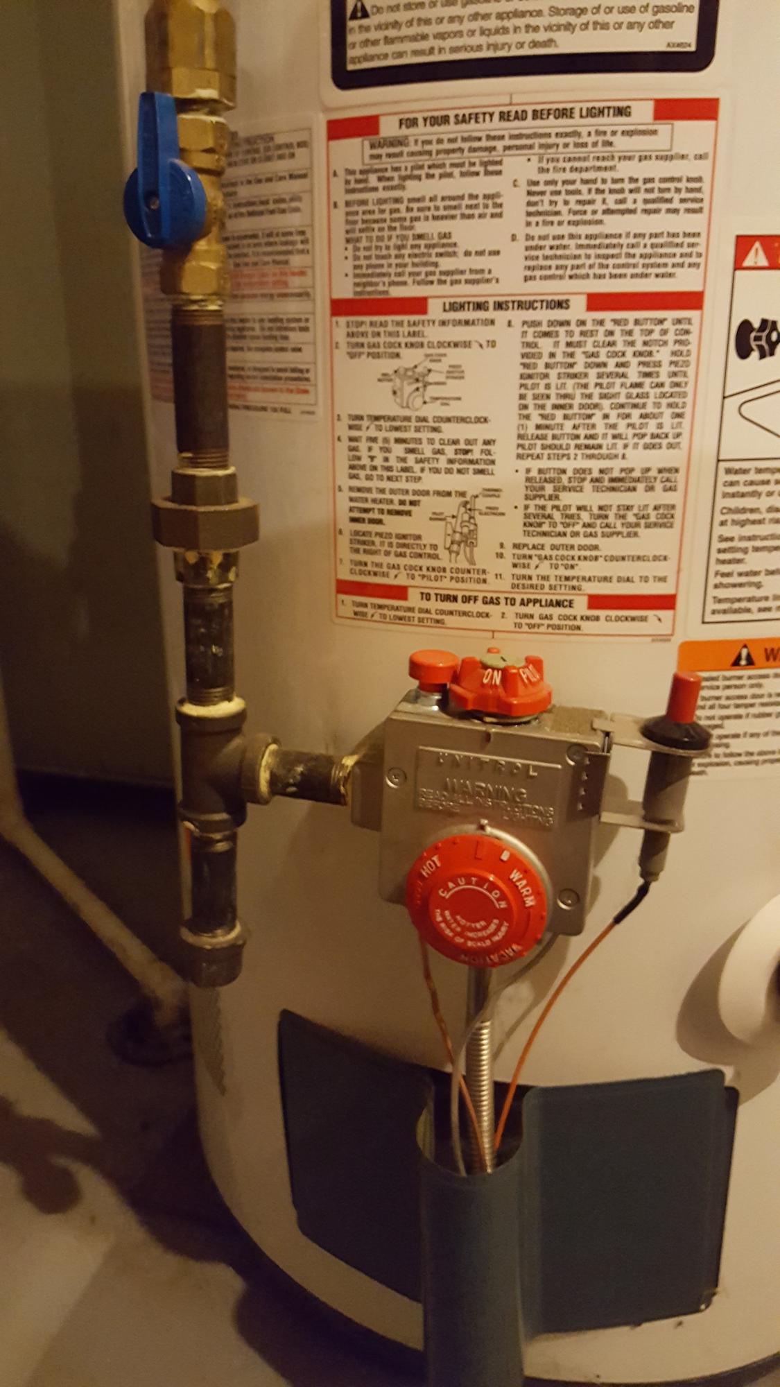

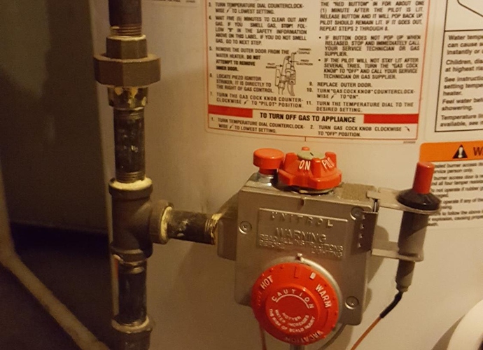

This image shows a typical gas line hookup to a water heater in an older home. The drip leg is very small (2”) but it is located upstream from the shut off valve. This is incorrect since you cannot turn off the gas to clean out the drip leg. Also, the PTFE tape is white not the yellow rated for gas lines.

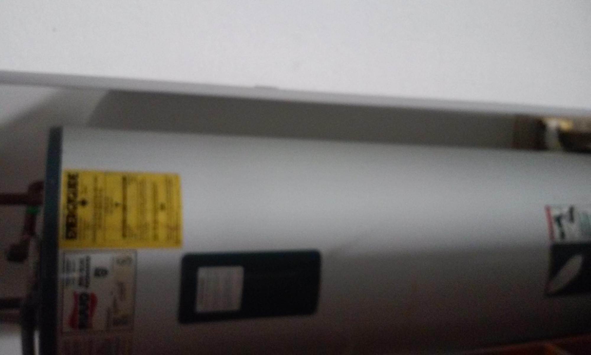

The water heater that I attempted to inspect was in a condo. The tank was in a corner of the kitchen blocked in by the cabinets and stove. It would be very hard to evaluate this unit without moving the stove. I could not see a any components in this spot. It would be hard to turn the water off if it to needed to be repaired.-
