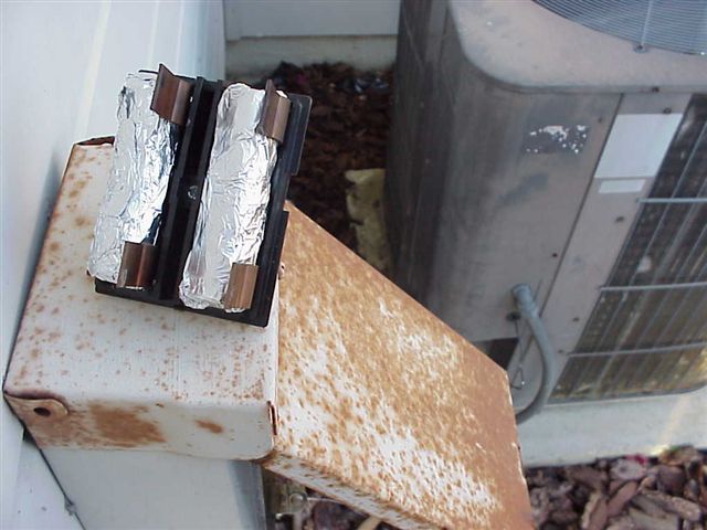

So your answer would be “NO” and your excuse is that it’s not specifically spelled out in the SOP. Curiously, I don’t even see checking for the presence of a disconnect means in the SOP, aside from the main service disconnect. Does that mean you don’t report if there is no disconnect at all for the AC condenser, electric water heater, furnace/air handler?

I do routinely check for the presence of a disconnect. I also check for equipment ground connections, signs of conductor overheating and line/load orientation. With most enclosures that does require pulling the disconnect handle.
I am not sure it is a good idea to be pulling fuses and tripping mains to see if they are functional as part of a Home Inspection and have never seen anyone around here do so.

Same here, I don’t pull fuses/breakers. The equipment may not turn back on. What do you do when you shut down an A/C unit on a 90+ degree day and the 90 year old owner is without A/C?? I just dished out $3400 for an A/C unit for my mother-in-law in Florida because she had a $35/visit handyman check it out.

If you do not pull fuse blocks at AC disconnects then how would you find things like this?
Is this not a reportable condition?

Pulling the fuse block (when system is off) and checking fuse capacity and wiring may be beyond your SoP’s but what about standard of care? Do you pull the dead front off a main or sub panel? If yes, then why not on a disconnect panel?

These devices are a means of disconnecting electrical power. They are intended to be operated. Why is operating them such a big liability?
If the 90-year-old lady’s disconnect doesn’t work when you test it, there is a high probability that it may fail or do something like burn the house down!
Exercising a fuse block that fails is simply “failed during testing”.
If you don’t pull it apart, you can’t tell if there’s anything wrong.
