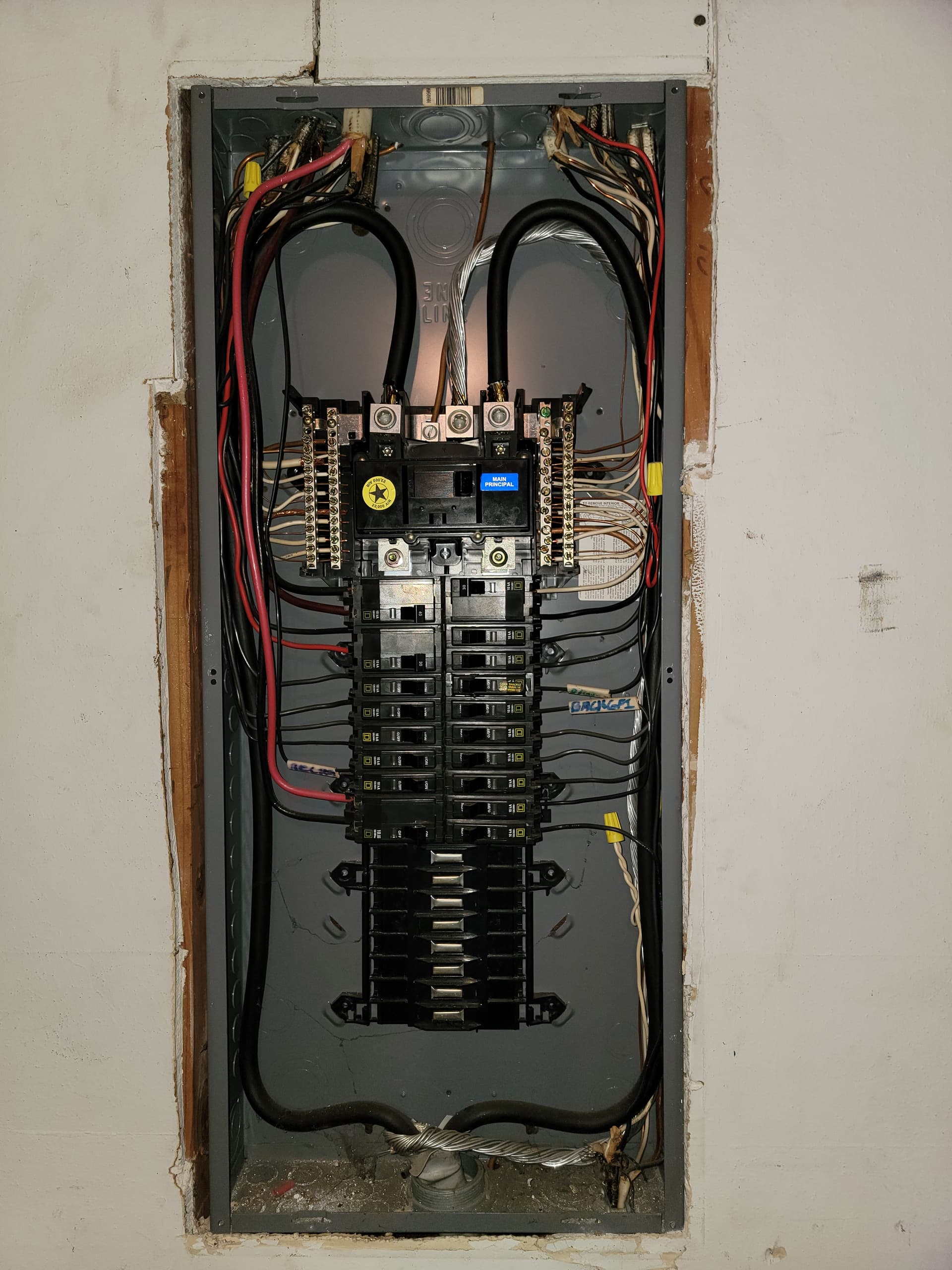

What I see on a ongoing basis is DIY electrical work. Are you suggesting that if an Ohio Home Inspector finds a #14 on a 30 amp breaker that he should disregard it?
More nonsense. Are you telling us the HI should not check for and call out 18 gauge wire connected to a 20amp breaker? Sizing according to NEC and checking basic gauge sizes is not performing a code inspection. Improperly spliced GEC also not a safety but a code inspection? Calling out uneven steps as a trip hazard is not a code inspection! albeit it’s part of IRC code. Furthermore, most of NEC is based on safety.
As I read MP’s post the answer is yes they should disregard it and let the circuit burn if that happens!

Yeap, which is why I posted someone needs to get to the bottom of this with the OHIB. He is basically stating most inspectors in Ohio are breaking the law, because I just don’t see how you can inspect the electrical system without inspecting items that are part of the code. It’s just not possible. The code part applies to other systems as well, not just electrical. To me, a code inspection is an exhaustive inspection that verifies code compliance in full. Home inspectors, while inspecting some parts, do not verify full code compliance. For example, we don’t perform load calculations, however, if we see a 10,000 sqft house with 100amp panel and everything in the house is electrical, how the hell can we not call that out? MP will yell that’s doing a code inspection.

Is this a safety hazard or a serious hazard?
