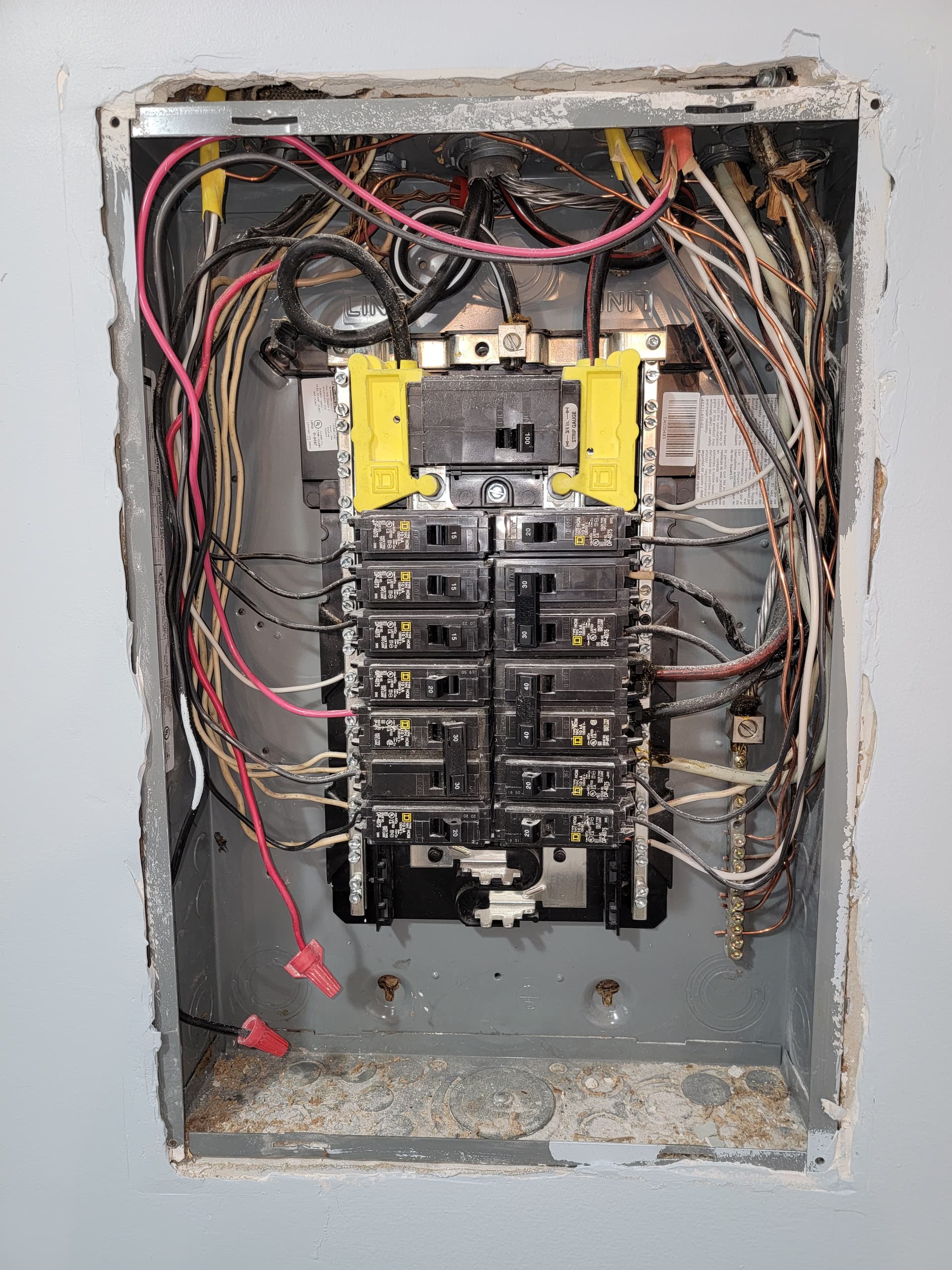

Kevin I cant believe You took the cover off of that service panel…I certainly hope You had the good judgement to look away quickly and not to comment on anything You might have observed while it was off…Obviously You have no shame man to scoff the authority like that…If they turn You into a frog and banish You from the state You only have Yourself to blame…You can’t say that You were not warned…

In Ohio that is not a serious hazard. That is not my opinion. That is what I have been told.
I think that it is FU and would say that it scares the hell out of me but it doesn’t meet the definition of serious hazard. Throw rocks at the state not me.
How many defects did you find? I found 2.
BTW it is code compliant with the defects. Chapter 34 OBC. They are not serious hazards.
It scares you, as a licensed code inspector, but it is not a serious hazard? How does that work?
Is a serious hazard something that comes after the fact? When the home is burned down?
Looks like they used 3 or 4 individual 14 Gauge conductors as the service neutral, and at least one is broken.
Also WAY undersized, but that is not a serious hazard?
Not according to the state. That doesn’t mean that it is not a huge concern. I don’t make the definitions.
In an enforcement capacity I can’t say that. That is the Building Official’s job.
Serious hazard in a nut shell means that someone is going to get hurt or die in the next 5 minutes. A serious hazard allows the BO to act NOW and not have to wait.
As a private inspector I never say that because I have never seen anything that meets that standard. That high standard is left to BO’s in Ohio. Like it or not that is the law. That is why that language was added in the Canon of Ethics.

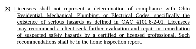

“(T) A licensee shall inspect a propertys readily accessible components of the electrical system during a home inspection and report in the home inspection report the licensees findings related to all of the following:”
readily accessible was added.
ASHI members were there and objected because it was different than their SOP.
" (8) Licensees shall not represent a determination of compliance with Ohio residential, mechanical, plumbing, or electrical codes, specifically the existence of serious hazards as defined in rule 4101:8-2-01 of the Administrative Code. Licensees may recommend a client seek further evaluation and repair or remediation of suspected safety hazards by a certified or licensed professional. Such recommendations shall be in the home inspection report."
Was added when I asked the OBBS to address the subject of code inspections and give their input to the OHIB. This was to help new inspectors understand the limitations of their licence. I knew Ohio law was confusing and I thought that addressing this subject would help inspectors from violating Ohio law.
