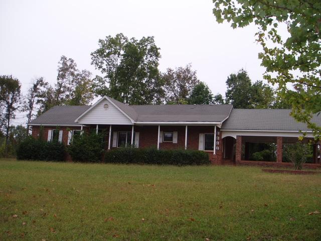

Guess what type of home this is? Hint: it can be yours for $55K.
Do modular homes have tie down straps?
Foundation anchors…
Thanks for the input. I went to the home today and found it to be a manufactured home complete with 4/12 roof pitch, metal framework (w/o axles or tongue), the entrance door is 6’3" x 32" instead of 6’8" x 36", 3 HUD tags, tie downs, block piers, and black plastic sheeting on the underside of the floor joists. The home has an “energy saver package” which includes 2x6 walls. Does anyone think that this home (removing the metal undercarriage and complying with local codes) could be reclassified as a modular? Thanks, Terry
