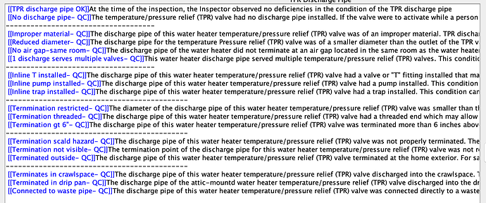

Here’s a list of /TPR discharge pipe defect narratives from my Home Inspector Pro template. Think a new inspector is going to know all these? No. But if he knows that he has a list of defects just for TPR discharge pipes in his narrative library, he can check, and he may learn something in the process.
There are narratives in a large library the use of which are limited to certain conditions, or certain climate zones, or certain jurisdictions. Inspectors have to take responsibility for what they put in their reports. They have to read the narratives before they put them into the report, and if it needs to be edited, it’s their responsibility to make an appropriate edit.
A narrative library is a tool designed to make life easier and more efficient for inspectors, but that’s all it is. It’s function is to save the inspector time, and for newer inspectors, it’s also an educational tool.
