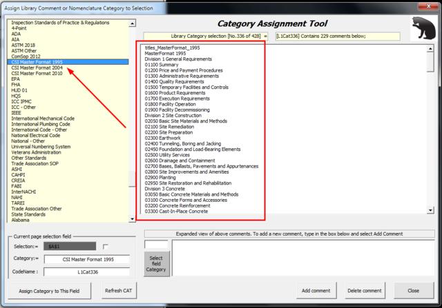

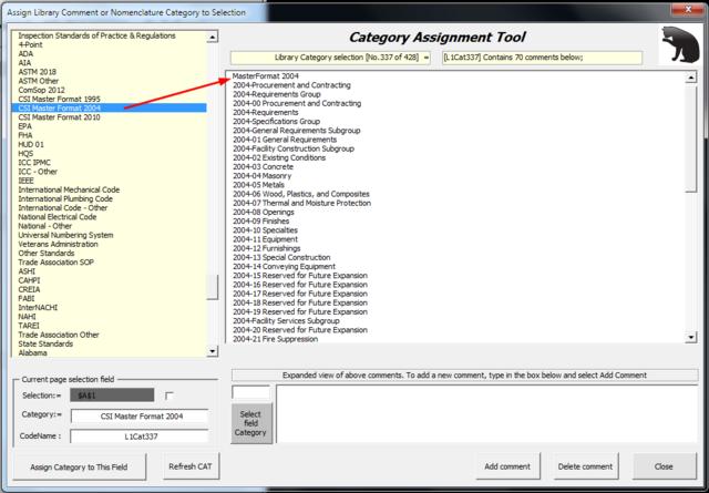

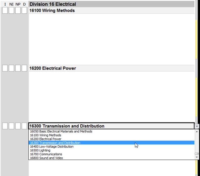

I won’t go so far as to say my software was built around Master Format but it was built with Master Format in mind. My software is structured differently from most inspection software. When I got into home inspection, there wasn’t much in the way of software available so there were no industry paradigms to influence my design strategies. I had already been doing software for project managers and contractors for many years so I carried much of what I knew from that world into my home and commercial building inspection software.
A primary goal of my inspection software is to be adaptable to any type of structure and any set of standards. Every non-residential project I have ever participated on has used Master Format so I wanted to be able to incorporate it easily into report templates.
It is possible to build templates using any edition of Master Format (or any other industry standard for that matter). I have attached a few screen shots to show how Master Format is incorporated into my inspection software.

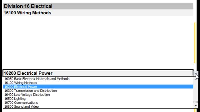

In the previous message, I attached a screenshot of the part of the report body. There are checkboxes in that screen shot that can be turned of. As you can see in this screen shot, when the checkboxes are turned off, the narrative section is automatically widened to fill the width of the page.
