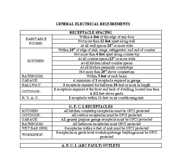

Guess I better delete this chart you provided.
[http://i191.photobucket.com/albums/z303/starstream4627/electricrecepticlerequirements.jpg?t=1231468181](javascript:void(0):wink:
